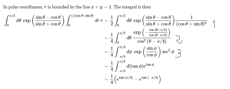

Let D be the triangle with vetrices ##( 0,0 ) , ( 1,0 )\mbox{ and } ( 0,1 )##. Evaluate the integral :
$$\iint_D e^{\frac{y-x}{y+x}}$$
[/B]
The answer to this problem is known ( https://math.stackexchange.com/ques...forming-to-polair-coo?answertab=votes#tab-top ), but I am trying to understand some steps:
How could we get ##sin \theta + cos \theta = 2 cos (\theta - \pi / 4)## ?
I do not how to get from 2 to 3 neither.
Thanks.
We don't. The trig identity used is that
##\sin \theta + \cos \theta = \sqrt2 \cos (\theta - \pi / 4)##
and it comes from the trig identity:
##\cos(a+b) = \cos a\cos b - \sin a\sin b##

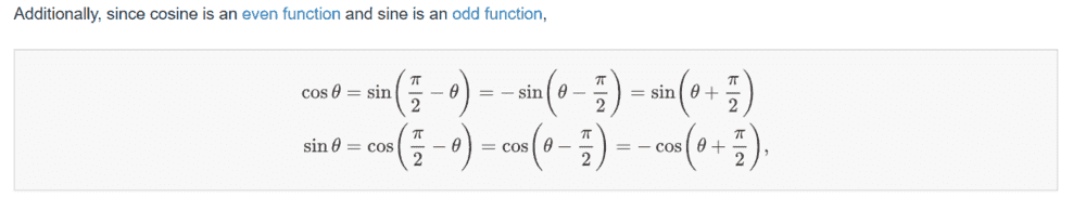

OK Thanks. Now I know that the following change of variables follows:
$$\phi = \theta - \pi / 4$$
And knowing that the cosine is an even function and sine an odd one:
We get to 3

But now I do not know how to get to
$$\int_{-\pi/4}^{\pi/4} d(\tan{\phi}) e^{\tan{\phi}}$$
Is it another change of variables?
Sort of. It's an ordinary substitution, with ##u = \tan(\phi), du = \sec^2(\phi)d\phi##. The integral just before that line, slightly rewritten, is
$$\int e^{\tan(\phi)} \sec^2(\phi) d\phi$$
[/B]
Thanks.
If all you want to do is evaluate the 2D-integral, then going over to polar coordinates is just about the hardest way to do it. Much better: stay with cartesian coordinates, but change variables to ##u = x+y, v = x-y##. The integration region in ##(u,v)##-space is nice, and integrating first over ##v## and then over ##u## is simple.
