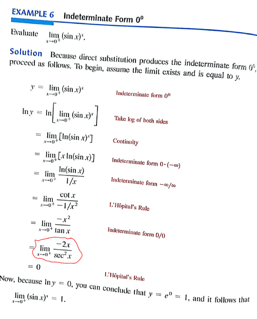

Evaluate ##\lim_{x→0^+} (\sin x)^x##
(Textbook example).
Limits
Textbook worked solution for the limit of (sin x)^x as x approaches 0 from the right, showing steps from ln y through L'Hopital's Rule, with annotations naming each indeterminate form; the final step is circled in red.
Ok, to my question; was the step highlighted necessary? The working steps to solution are clear. Cheers.
The line before is
\lim_{x \rightarrow 0^+} \frac{-x^2}{\tan x}
which is the indeterminate form 0/0, so L'Hôpital's rule has to be applied again.
Alternatively [tex] (\sin x)^x = \left(\frac{\sin x}x\right)^x x^x = \exp\left(x\ln\left(\frac{\sin x}x\right) + x \ln x\right)[/tex] and use that [tex]\begin{split}<br /> \lim_{x \to 0} \frac{ \sin x}{x} &= \sin'(0) = 1 \\<br /> \lim_{x \to 0^{+}} x \ln x &= 0 \end{split}[/tex]
Okay...I missed that.... We are avoiding to divide by ##0## on denominator that will give (indeterminate form).
Thus
##\lim_{x→0^+} [-2x\cos^2 x] =0##
Cheers.
chwala said:
Okay...I missed that.... We are avoiding to divide by ##0## on denominator that will give (indeterminate form). Thus
##-2x\cos^2 x## on numerator.
Cheers.
It's not just that the denominator is zero in the limit -- it's because the numerator is also approaching zero. Thus it's the ##[\frac 0 0]## indeterminate form, as @DrClaude mentioned.
@Mark44 hi... I understand that too. Thks mate... My problem was on the highlighted part in red. Taking limits as indicated for my expression in post ##4## will realise the given value ##0##.
There are only two cases where L’Hospital’s rule can be applied, ## \frac{0}{0} ## and ## \frac{\infty}{\infty} ##, and both of them you have in your example.
pasmiths argument seems possibly to justify my feeling that since sin(x) is tangent at 0 to x, the limit should be the same as that of x^x? (i.e. 1). maybe too optimistic/lazy.
