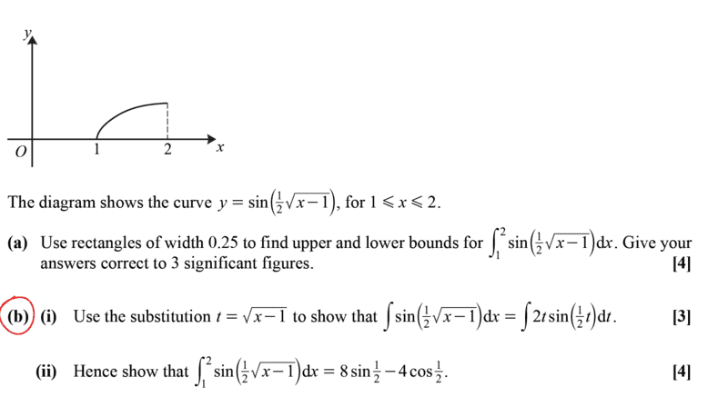

Evaluate the definite integral in the given problem
chwala
2,854
436
See attached.
Integration by parts.
My interest is on the highlighted part only. Find the problem and solution here.
Exam question: graph of y = sin(½√(x−1)) for 1 ≤ x ≤ 2, drawn from x = 1 to x = 2 above the x-axis, followed by parts (a), (b)(i) and (b)(ii) on integrals of sin(½√(x−1)).
Marking scheme table for part (b)(ii): integration by parts of -4t cos(t/2) + 4 cos(t/2) dt giving -4t cos(t/2) + 8 sin(t/2), then applying limits to reach 8 sin(1/2) - 4 cos(1/2) AG, marked [4].
This is clear to me (easy )...i am seeking an alternative way of integrating this...or can we say that integration by parts is the most straightforward way?
The key on solving this using integration by parts is to note that;
##u=t, du=dt, dv=sin \frac {1}{2} t, v=-2 cos \frac {1}{2} t##
I am not sure but afraid that we have no better way.
