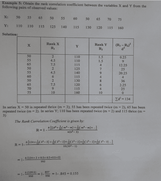

Calculate the rank correlation coefficient of the given problem
2 replies · 5K views · last reply
chwala
2,854
436
See attached.
Spearman's rank correlation coefficient.
Find the problem and solution here; I am refreshing on this topic of Correlation.
Printed worked solution for Example 5: a table of paired X and Y values with ranks and rank differences squared, followed by the tie-corrected Spearman rank correlation formula and the result 1 - .845 = 0.155.
The steps are pretty much clear..my question is on the given formula ##\textbf{R}##. Is it a generally and widely accepted formula or is it some form of improvised formula approach for repeated entries/data? How did they arrive at... ##m^3-m?## ... Any proofs? Supposing ##9## entries are repeated and ##1## entry is different would the formula still hold?
Are there other different ways of solving this particular problem?
Cheers...

This just measures the degree to which the two rankings agree. There are other such measures:
https://en.wikipedia.org/wiki/Rank_correlation
https://en.wikipedia.org/wiki/Rank_correlation/Spearman%27sSpearman's ##\rho## as a particular caseEdit: I think the expression ##m^3 -m## comes from properties of the Uniform Distribution
Edit 2 : Per the article linked, this is the case, i.e., the expression ##m^3-m ## ad others are derived from the Uniform Distribution:
Ranks are just elements of permutations
of ##S_n## , the group of permutations of the elements in ##\{ 1,2,3,..n\} ##
