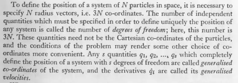

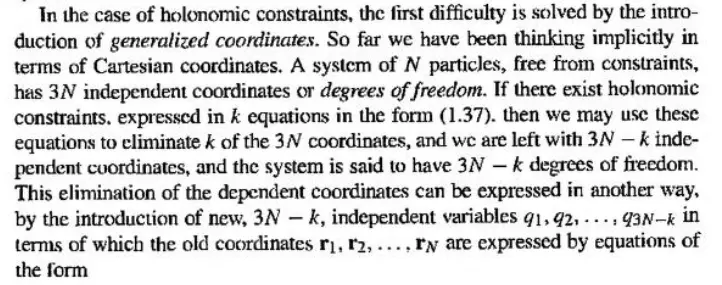

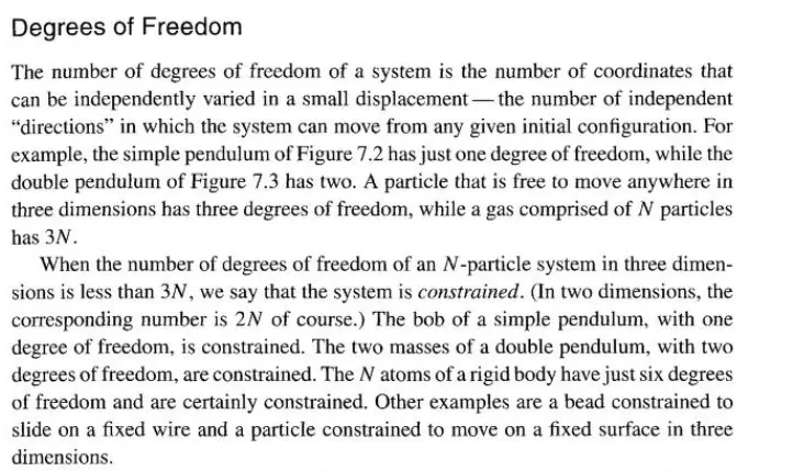

The ##3## degrees of freedom of a classical free particle are accounting precisely for the "freedom of motion", as they correspond to the ##3## independent directions along which the free particle can move. Hence their name, the translational degrees of freedom. Likewise, there are rotational degrees of freedom, vibrational degrees of freedom etc.
Below are some excerpts on the degrees of freedom, taken from textbooks on classical mechanics:
1) L. D. Landau & E. M. Lifshitz, Mechanics (3rd ed.), Butterworth Heinemann 1976:
2) H. Goldstein, C. Poole & J. Safko, Classical Mechanics (3rd ed.), Addison Wesley 2000:
3) J. R. Taylor, Classical Mechanics, University Science Books 2005:

In mechanics, degrees of freedom are understood in the same sense that is given in the textbook passages I sampled in post #7 above. It is the number of independent variables that need to be specified in order to completely define the configuration of the system (given as a point in configuration space, the space of generalized coordinates ##q_a(t)## of the system). The system composed of ##N## free non-interacting point particles has ##3N## degrees of freedom (not ##6N##), but if these particles interact with each other or are "held" together by some constraints, then the number of degrees of freedom ##s \leq 3N## may be smaller than ##3N##. For example, the system of two completely free particles has ##3+3=6## degrees of freedom; if these particles are connected by some "rigid rod" of length ##l## then the number of degrees of freedom for such a system is ##6-1=5## (because the ##6## coordinates ##(x_1, x_2, x_3)## and ##(y_1, y_2, y_3)## of the two particles satisfy the additional ##1## constraint ##(x_1-y_1)^2 + (x_2-y_2)^2 + (x_3-y_3)^2 = l^2##).
If the classical system has ##s## degrees of freedom, then their time-evolution is obtained by solving the ##s## 2nd-order Euler-Lagrange equations, one equation for each degree of freedom. However, instead of solving the ##s## 2nd-order differential equations, you can alternatively solve ##2s## 1st-order differential equations (Hamilton's equations) and this gives you this ##2s##-dimensional phase space. Note that the number of degrees of freedom in both approaches is ##s##, the difference is that you reduce the order of the differential equation to be solved by replacing it by several lower-order differential equations.
