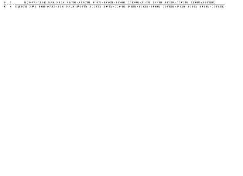

I am trying to create a Tool in VBA that reads the nonsense that you get when you save a file from Mathematica as .txt and rewrites it into a format that excel can more readily use.
I am having difficulty "decoding" Mathematica's syntax. For example:
This is what I have as an expression:
and this is how Mathematica outputs it to a .txt file

It looks tricky. I'm wondering if this is the best approach. I'm not sure what capabilities mathematical has but maple I belie writes you choose to write an expression as latex or mathml. I'm wondering if the processing of the file should be done in mathamatica instead of externally though visual basic. However, I guess this wouldn't work so well, if you were trying to read other peoples files and you didn't have access to Mathamatica.
It's not tooo bad... It uses a "\" before any kind of operation except for + and - as well as a space-"\" for a line continuation.
It's just the seemingly arbitrary use of parenthesis.
