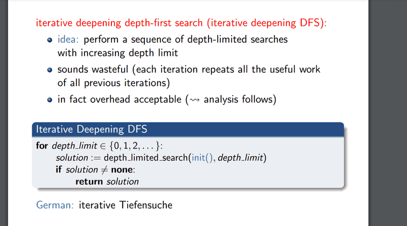

iterative deepening depth first search
code given below
This code is for iterative deepening depth first search in python.
Python:

There are various pseudocodes available for this problem. They are as follows-:

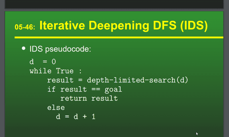

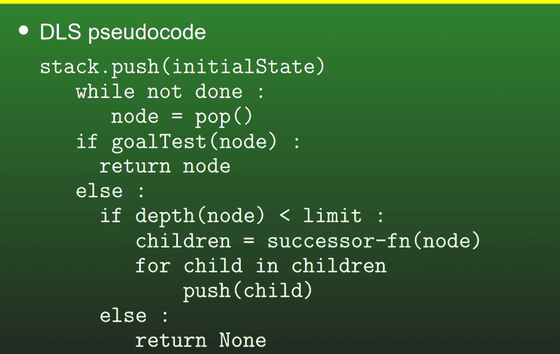

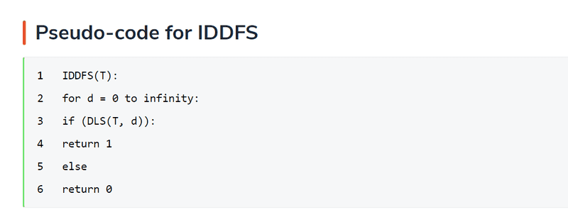

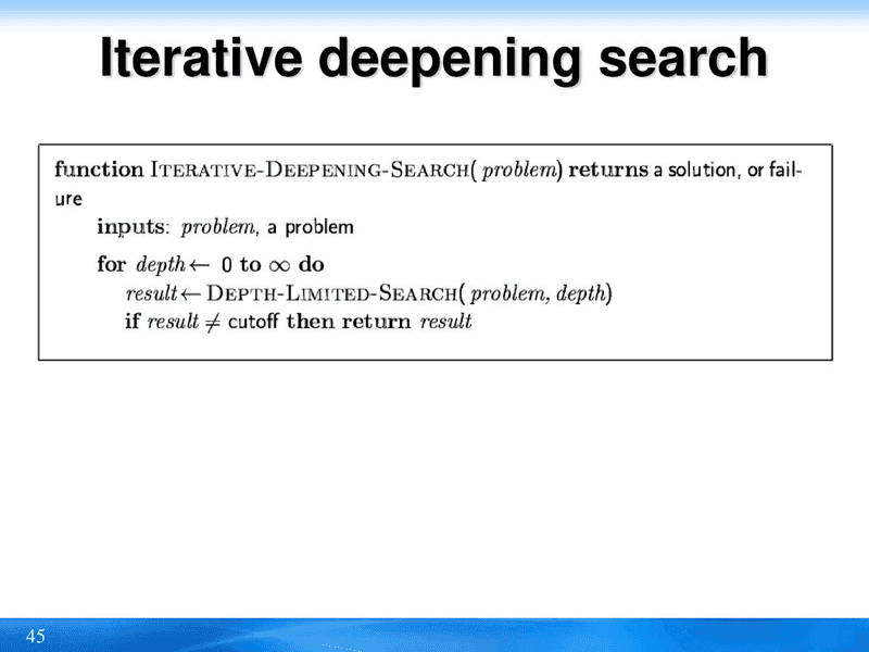

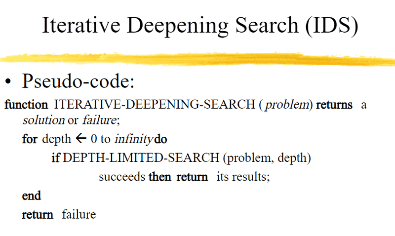

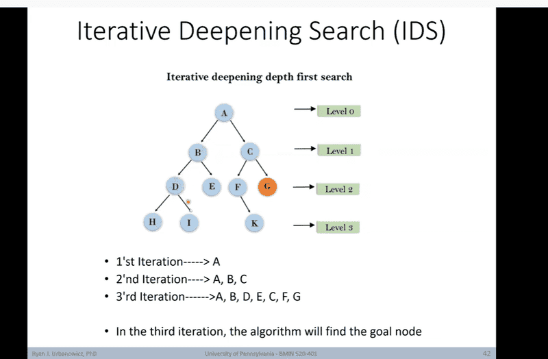

I did my best to understand and implement the code but I seem to have failed. And it is getting really confusing. Can you help me?
Slide titled Iterative deepening search showing pseudocode for function ITERATIVE-DEEPENING-SEARCH(problem), with a for loop over depth from 0 to infinity calling DEPTH-LIMITED-SEARCH until the result is not cutoff.
Slide titled Iterative Deepening Depth-first Search defining iterative deepening DFS and giving the Python-style pseudocode loop over depth_limit with depth_limited_search.
Slide titled Iterative deepening search with bullet Use DFS as a subroutine and numbered steps: 1. Check the root; 2. Do a DFS searching for a path of length 1; 3. If there is no path of length 1, do a DFS searching for a path of length 2; 4. If there is no path of length 2, do a DFS searching for a path of length 3...
Slide titled 05-46: Iterative Deepening DFS (IDS), showing IDS pseudocode: d = 0, while True, result = depth-limited-search(d), if result == goal return result, else d = d + 1.
Slide titled DLS pseudocode showing a stack-based depth-limited search: push initialState, loop while not done, pop a node, return it if goalTest succeeds, otherwise push its children if depth is under the limit, else return None.

Slide titled iterative deepening depth-first search (iterative deepening DFS) with bullets on its idea, cost and a pseudocode box: for depth_limit in {0, 1, 2, ...}, solution := depth_limited_search(init(), depth_limit), if solution != none return solution. German: iterative Tiefensuche.
Slide titled Iterative Deepening Search (IDS) with pseudo-code for function ITERATIVE-DEEPENING-SEARCH(problem) that loops depth from 0 to infinity, calling DEPTH-LIMITED-SEARCH and returning failure at the end.
Pseudo-code for IDDFS: numbered lines 1 to 6 defining IDDFS(T), a loop for d = 0 to infinity, if DLS(T, d) return 1, else return 0.

Slide titled Iterative Deepening Search (IDS) showing a tree diagram of nodes A to K with node G highlighted in orange, levels 0 to 3 labelled on the right, and iteration lists below.

  1. Post Python code with the starting tag CODE=Python
  2. In line 17 you have
    Python:
    def dls(visited, graph, node,depth_limit):
    Apart from the inconsistent spacing and the obscure name, do you not think that the value you are searching for should be an argument of the function?
  3. In lines 40-44 you are getting confused between depth, which you never initialise, and the global variable depth_limit, which I suggest you rename initial_depth_limit.
