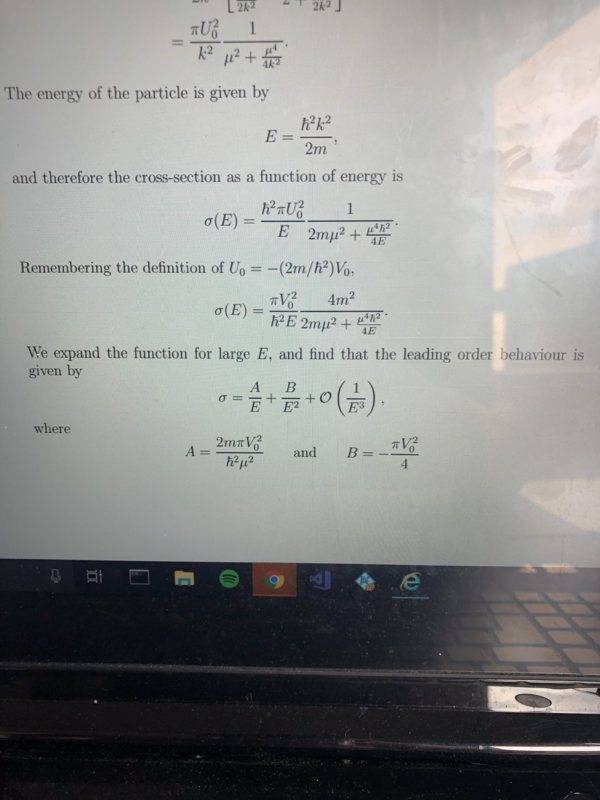

Obtain leading order behaviour of function
*See attached image*
I have been playing around with Taylor expansion to see if I can get anything out but nothing is jumping out at me. So any hints, suggestions and preferably explanations would be greatly appreciated as I’ve spent so so long messing around with it and I need to move on...
But as always, thank you
We have <br /> \left(C + \frac{D}{E}\right)^{-1} = \frac{1}{C} \left(1 + \frac{D}{CE}\right)^{-1}. For sufficiently large |E| we have |D/(CE)| &lt; 1 so we can use a binomial expansion.
Likes CricK0es
Ahhhhhh Binomial! Okay. Always seems to be simple things that I don’t recognise that hold me up... pffh Nevermind.
Thank you!
