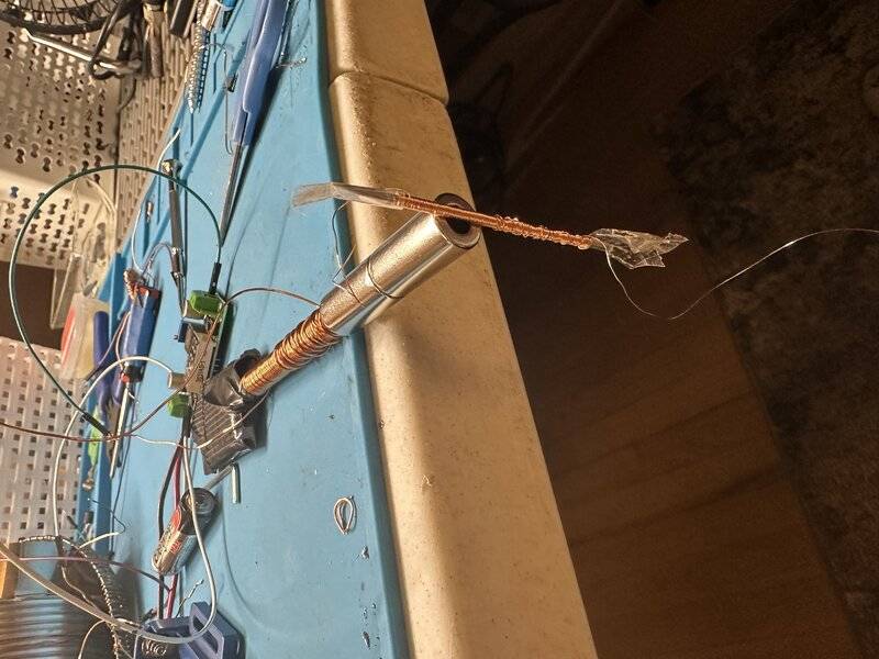

The experiment consists of two inductors as previously mentioned, perpendicular to each other (one horizontal and one vertical), and I power the horizontal one to create a magnetic field and then I stop powering it after giving it some time to build magnetic energy and as the current drops so does magnetic field intensity therefore the flux drops and it results in a change in flux with respect to time therefore inducing emf into the second, vertical inductor.
Subsequently, I attached two probes of a MM at the end of the vertical inductor to measure the induced voltage. What I found quite odd was immediately after I powered off the horizontal inductor and began measuring the voltage in the vertical, I measured no induced voltage yet a compass I had on standby, was pointing towards it even as I revolved it around the vertical inductor showing it had its own magnetic field, and the only way it could’ve gotten that was by being induced with an EMF which then would store it as magnetic energy. Compasses are very sensitive unlike an MM so perhaps my MM didn’t catch the induced voltage although the MM was on mV mode therefore it’s unlikely it didn’t catch it cause the emf was probably in the mV range.
One thing I would like to mention as it’s quite important to know, is that I powered the horizontal magnetic field via a short (no resistance) by wiring up some AA’s batteries in series to obtain 7-8 V. I originally had resistors but I found they significantly hindered the strength of the magnetic field, on top of the fact I’m struggling as is to get proper readings with my MM.
Anyway, I attached a picture of my setup so you can see it. The core is a drill bit with a 2000 relative permeability I presume (steel core). The horizontal magnetic field is 175 windings at an estimate, 178mm in length, with a 5mm core diameter. And the AWG of the windings is 22. The vertical inductor is 252 windings, 56mm long, and 2.5 mm core diameter. With a AWG of 30. Moreover, the vertical inductor is held by a magnet in this picture however that was just to hold it for the picture so you can see how it was positioned during the experiment.
Additionally, with the magnet seen in the picture I did a side experiment by taking off the vertical inductor and varying the distance between the magnet and vertical inductor(basically if the magnet is in one hand and the inductor is In the other, just imagine bringing my hands further and closer together). By doing it I was able to develop a magnetic field powerful enough to pick up a small screw. I presume the magnet induced an EMF by varying the magnetic field strength/field flux.
Next, while the inductor still had its magnetic energy stored I decided to use my MM to again measure any possible induced voltage but I measured nothing which confused me. I’ve gone to my teachers who say my MM works just fine and isn’t the issue.
Moreover, my math also isn’t making any sense, as I’m predicting an EMF of 30-0.3V within 5 time constants of not powering the first magnetic field(yes volts, not mV) which is obviously wrong. I feel it would be best to fix the observations first then I’ll further discuss my math as to not make this thread too long.

You are trying to couple energy between orthogonally oriented coils?

You have arranged the coils in a symmetrical way, such that the magnetic fields of the two coils do not couple. The magnetic compass is a more sensitive instrument, and is in a better position to detect the field.
If you lay the coils parallel, and next to each other, in an arrangement more like a transformer, you will detect a greater output.

You will simply not get significant coupling between inductors with perpendicular magnetic fields.
Frankly, the approach I would take would be to simply use an ordinary antenna to receive the radio signal, convert that to an ordinary electronic voltage signal, and then use that electronic signal to drive the optical device. The reason those things are ordinary is because they work.

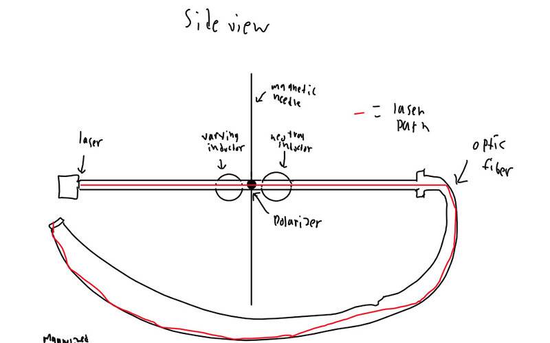

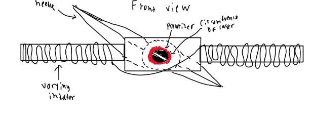

Dale; so I’ve been taking a while(basically the whole day) to respond as I’ve been reviewing the resources you’ve provided and going back to the drawing board as you had suggested. I know the existence of pulse code modulation however the medium of optical fiber I didn’t know. I’ve thought of a new way to redesign my experiment and please correct me if this is wrong. I’m sure my explanation isn’t enough so view the diagram as needed for your reference.
Now to explain the diagrams: Instead of making the vertical polarizers perpendicular to the horizontal magnetic field, this magnetized needle (basically a compass needle) with a polarizer imbedded in the middle of it is in the same direction as the horizontal magnetic field. The needle is held up by a hollow rod that also holds up two other inductors, one behind and one in front of the magnetized needle.
The inductor I labeled as “varying inductor” is where the rf signal will go and it will reproduce the varying magnetic field as described. In the experiment I would use this in, I wouldn’t send rf signals but let a magnetic field decay to represent a changing magnetic field strength. Anyhow, this magnetic field will attempt to align the magnetized needle with its magnetic field. In this experiment I need to have the needle have a neutral position, to differentiate and classify different magnetic field strengths which is where the second inductor labeled the “neutral inductor” comes into play.
Basically, my logic is, since I plan to modulate the signals based on em wave polarity, I need the needle to turn in order to rotate the polarizer imbedded in its center, however, what I noticed was that it would not rotate as an inductor began slowly losing its strength once unpowered. This was due to its sensitivity making it impossible to know when the magnetic field strength is at its max or min. Therefore the neutral inductor induces an opposite magnetic field to that of the varying inductor, not necessarily to cancel it out but to apply constant force in the opposite direction to cause the needle to rotate in the tug of war between the two inductors.
The laser or LED beam would go through the changing polarizer and into an optic fiber which comes back to me so I can observe the polarization of the laser with the naked eye.
Again, this might be wrong and unknowingly to me might be silly as I might’ve overlooked common flaws with it, but a different approach is better than forcing an inefficient existing one as you had mentioned.
Ultimately an issue I hadn’t previously mentioned that comes with modulating polarity is the many refractions that occur especially in the optical fiber that can disrupt and change the polarity (which is the main reason polarity hasn’t been modulated). However, after this experiment described above, by describing the em waves as photons rather than waves, I suggest we could use a photo multiplier to significantly increase the sheer number of photons which will then be polarized thereby increasing the insurance in case some photons are refracted. I’m not sure if this would actually work however it’s a theory beyond the experiment.

That is good. It is an important skill to go back to the drawing board in response to test results.
Dale, Is the concept good?
I have no idea what you are trying to accomplish, so I cannot judge if the concept is good or not. It seems like maybe you are trying to get a needle to point in the direction of the magnetic field of a radio wave. But I am not sure.
That is what I am trying to accomplish.
For what it's worth, you can modulate a solid state laser by making its power source voltage proportional to the modulating signal voltage. No coils or weirdness involved.

So, the problem with that isn't the device, it is the thing you are trying to accomplish. A fairly low radio frequency is 500 kHz. The direction of the magnetic field can change that fast. To point a needle with 1 cm radius in the direction of the magnetic field would require that the tip of the needle could go about 31 km/s. This works out to something like 90 times the speed of sound.
If you polarize the incoming wave, then the magnetic field will change direction about once every microsecond. So, you would have to be able to flip the direction of the needle in a microsecond. That will be similarly tough. I think it would be difficult to even build a needle that could withstand those forces, let alone a mechanism to deliver them.
