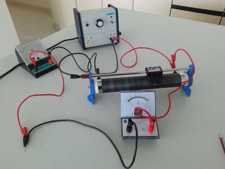

In this experiment, we're trying to study the characteristics of a light bulb. Here are the steps outlined for us:
1. Use a potentiometer to vary the voltage across the bulb measured by the voltmeter V. Collect data of V-values and corresponding I'-values from the ammeter over the voltage range 0-12 V.
2. Remove the bulb from the circuit and repeat (1) using identical voltage values. The new current values i represent the current drawn by the voltmeter itself during part (1). Tabulate I' and i with corresponding V, then calculate the corrected values I = I' - i, tabulating these also.
R= v/I and P=VI
We are able to set the experiment for part (1) and we get the values required. For the second part, the only problem is, we are using a rheostat as a potentiometer so we've connected all three terminals of the rheostat. The bottom two terminals of the rheostat have been connected to the D.C power supply and then another connection was made to the voltmeter from the wiper to one of the bottom ends as well and we got ourselves a potential divider.
Now the only concern is where do we place the ammeter to be able to measure the current? We've tried different positions but most of the time, either the ammeter would work alone or the voltmeter, never together!
Since the instructions mention 'the current drawn by the voltmeter itself", it seems they want you to measure the current through a palallel circuit of bulb and voltmeter:
But in the second part they mention that we have to remove the bulb?

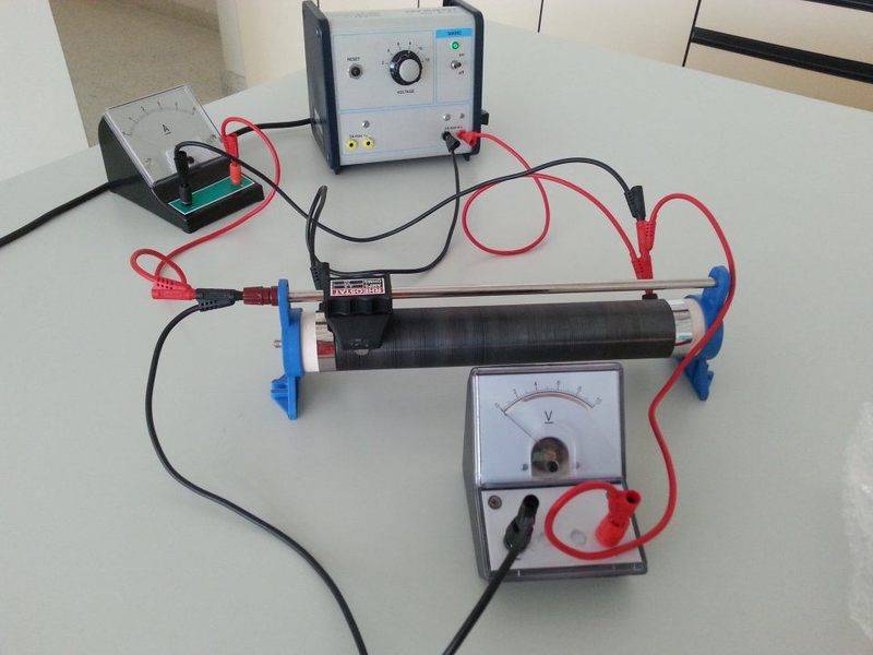

Unplug the two plugs at the left end of the rheostat, but do not separate the plugs from each other (that is the black plug from the voltmeter and the red plug of the ammeter in the photo, they are plugged into the slider of the rheostat).
Now unplug the black plug of the ammeter at the other side of the rheostat (it is plugged into the other two red plugs).
Insert this plug where you removed the previous two plugs - that is into the slider of the rheostat.
The ammeter will now measure the current drawn by the voltmeter.
Where do I plug in the two plugs (the black plug from the voltmeter and the red plug of the ammeter) that I removed from the left side of the slider?
Ah I think I might have understood. As per my understanding, there's a direct connection from the positive end of the ammeter to the negative end of the voltmeter directly? And the negative end of the ammeter is connected to the left end of the slider? Is that correct?
In your above image of the setup, the ammeter looks to be connected in parallel with the voltmeter. This is shorting the voltmeter out. I think this is why both the meters do not work at the same time. I believe andrevdh's advice in #4 will solve your problem.
So I tried it again today with the corrections mentioned and the ammeter doesn't show any deflection at all.
The ammeter should be in series with the voltmeter if you want to measure the current drawn by the voltmeter.

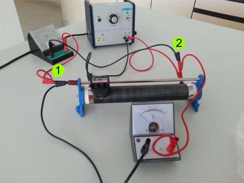

1. Remove the two plugs from the slider connection, but do not separate them from each other.
2. Remove the black ammeter wire from this point and insert it where you removed the previous two plugs, that is insert it into the rheostat slider plug.

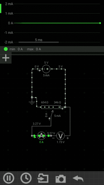

I believe this is how you have connected your setup (values may differ). Try increasing supply voltage (if the experiment permits..). It all depends on the voltmeter resistance.

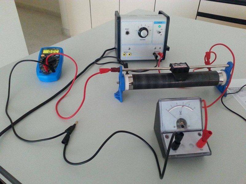

So I'm still not getting anything despite using a multimeter as well. I replaced the ammeter with the multimeter (exact same connections) but still no luck. I plugged the wires into the ground for the multimeter and V Ω mA for the second lead. Are these connections correct? When I connect the multimeter in parallel to the voltmeter I get the same voltage as on the voltmeter but when I connect it in series (same connections as analogue ammeter), it reads 0.00 whether it's set to μA, mA etc.
Is this correct? I don't get any resistance or current

Can you tell me if this connection is correct? Because this was giving me nothing.
When I connected the multimeter in parallel to the voltmeter, the multimeter would give me the correct voltage, current was still 0 and the resistance was showing as -1700 ohms?
It looks correct to me. The multimeter is in series with the voltmeter and it should show the current drawn by the voltmeter.

That's the thing the voltmeter stopped working with this arrangement
You mean in your above setup, when the multimeter is in series with the voltmeter, the voltmeter is showing 0V? If yes, then I think the voltmeter is damaged. In your above setup, the voltmeter should show some voltage.
