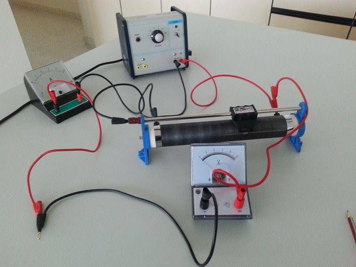

The voltmeter is working alright. The minute you disconnect the the multimeter it works. It was the same problem with the analogue ammeter. It shows some voltage as you move the wiper but I'm not sure whether that's correct because when the wiper is at the center of the rheostat, the voltage should be 3 V (half of what the power supply is set at).
SO when I connect the multimeter as such, I get readings.
BUT when I force the probes into the voltmeter real tight, the voltage goes up by a lot and the multimeter stops working so I presume I should just let them mildly touch. I hope this is correct. I'm only getting readings of upto 2 V maximum even though the power supply is at 6 V.
  • Lab bench setup with a power supply, a long resistance wire on a wooden board between blue clamps, an analog voltmeter, and a blue handheld digital multimeter showing a reading, with red and black leads connected.
  • Lab setup on a table: a benchtop power supply, a resistance wire stretched along a wooden board with clamps, an analogue voltmeter with red and black probes, and a blue digital multimeter showing a reading.
I still say both meters are hooked up in parallel...IF this is the case, well...I've said it too many times here already...
If they are, according to the photo, You are chasing the wrong dogs like internal resistances of a perfectly good meter, load etc, as some peeps have suggested...In over 20 years of lab work I have never seen a "bad meter". unless on of the cells went internally weak inside the meter, but that is rare..If it can max out via adjustment, in the resistance mode, it is good...
Would be nice if I could verify the connections to the variable resistor with a different picture angle..I cannot see clearly if there is a wire connected to the top slider of the variable resistor...Are you must be aware that a "Pot" can be hooked up as a rheostat (current divider) or a Potentiometer, (voltage divider)?

See that's the thing, with a series connection as in the picture in post 25 registers nothing at all. The variable resistor is being used as a potential divider so two connections are made to the power supply and one connection from the wiper to the voltmeter.

I cannot see the connection on the other side of the slider...so how can I comment?
Have you done point to point voltage checks whilst moving the slider to different positions? I have seen a lot of large pots have many dead spots due to arcing but that was always in very high power applications as in RF. :+50KV.
Again, it looks like the ammeter is hooked up in parallel... But without seeing it in a better light..I would be assuming...
Concerning your color leads, right now you have two that are swapped, which does makes it a bit more confusing when troubleshooting at a 2 dimensional picture.
Again, With that picture angle I cannot verify the slider connection.
Yes and this is what I have as per the schematic but it's not working! :H
Even if I replace the ammeter with a multimeter with the same connections i.e. in series, absolutely nothing happens! Our objective is to get the current through just the voltmeter.

I do not see a connection coming from the wiper? I'm I going blind?:oldconfused::oldsurprised:
The wiper is connected to one terminal of the ammeter and the other terminal of the ammeter is connected to the voltmeter.
I do not see a load of any kind.
I see P/S, two meters, a variable pot, and some connect wires...what are you using for a load?

I'm sorry I missed that... That current would be so small as not to be relevant...sounds like a bad procedure...Your instructor is going to know that the internal resistance of a voltmeter is so high as to draw just about zero amps...Its called loading effect, btw...I know what this experiment is trying to show..Ohm's law relations and maybe loading effect of different meters..
The meter "loading affect" ,I think is beyond the scope of this level...
This experiment was on the characteristic of a filament lamp, and the other one similar to this was the characteristic of a semiconducting diode.
Just one question, we are using an ammeter in both experiments, would a milli-Ammeter be better?
Taniaz said:
Yes they are in the first part of the experiment, then they ask us to remove the load and just measure the current through the voltmeter.
OK! Well if that's the case..A a good meter (current) ,you will read very little to nothing! I can tell you that..
The point of the experiment is to have you realize that current meters have very low internal resistances so the reading will be as accurate as possible..and that volt meters have very, very high internal resistances as not to load down the circuit..That I can promise you.
In the ans to the experiment just mention when you tried measuring the current w/o a load it was near zero, if not zero..That's what they want u to realize...

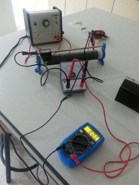

A closeup photo of just the blue CE multimeter will help.
That way we can instruct you how to use it to measure the current.
Anyway you should connect it just like the analogue one like I showed you.
Its black wire should be in the COM socket and it should be switched for DC (milli) amps.

Hello, so for the part with the bulb I disconnected the analogue ammeter and voltmeter and replaced them with digital multimeter.
The multimeter measuring the current was connected in series and the one measuring the voltage was connected in parallel.
I then disconnected the connections to the bulb and just tried to measure the current through the multimeter which was acting as the voltmeter.
The leads to the multimeter acting as the ammeter were connected to the 10 A connection and the ground.
The leads to the multimeter acting as the voltmeter were connected to the VΩmA connection and the ground. (I don't have a picture to go with this at the moment).
When I'd connect both meters to the 10 A connection, I'd get a reading on the multimeter acting as an ammeter and when I'd connect the multimeter acting as a voltmeter to VΩmA, it would give me a voltage but the multimeter acting as the ammeter would stop working.
The voltmeter has a very large resistance, so when you insert it the current would go way down creating the impression that the ammeter stopped working, but in fact the reading is way smaller so that you need to wire and put it on a much smaller scale setting. It is in fact dangerous to insert just the ammeter since it is creating a short circuit so that a part of the pentiometer is bypassed and much more current is drawn from the power supply, although it seems that the power supply has a reset button which would pop if you draw to much current from it.
We tried setting it to mA and micro-amps as well but it still showed 0. Yes the power supply does have a reset button, it usually resets when the wiper is allowing maximum current to go through.
It is set for direct current and not alternating current - assuming you are operating DC?
What make/model is is?
Also in this photo of yours you have to swop the red and black wires plugged into the ammeter around.
