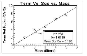

I am trying to experimentally derive the drag equation. I have dropped coffee filters with varying masses and determined their resulting terminal velocity. I plotted the data and found that the mass of the coffee filter is proportional to the terminal velocity squared. I was now wondering how I can use this to derive the drag equation, which states: F_D = .5CpAv2
At terminal velocity the known constant gravitational force is equal to the unknown drag force; equate them and do a bit of algebra and you'll have the ##v^2## dependency. You will also have to do some measurements with a constant mass and different surface areas to trade out the dependency on area.
Would you be so kind to explain this a bit further. The graph I obtained is attached.
  • Line graph titled Term Vel Sqd vs. Mass, plotting terminal velocity squared (m^2/s^2) on the y-axis against mass (filters) on the x-axis, with data points and a straight line through the origin labelled y = M*x, M = 1.6119, Mean Sqr Err = 0.128.
At terminal velocity the filter is not accelerating. So the forces acting on it must sum to zero. You know what the two forces are.
That's obvious but from the graph that I have provided can I derive that mg=dv^2 where d is the drag constant? Or can I show that the proportionality constant is equal to g/d somehow?

Your graph is for
v2 = mg/.5CpA
The standard equation for a straight line is..
y = slope*x + constant
but constant = 0
So in this case
y = v2
x = mass m
and the slope of the graph
= g/.5CpA
You know the slope.
You know the area A
You know g
That just leaves Cp.

I don't see how that would follow using only the graph. It follows from Newton's second law, and that ∑F=0 at a constant velocity.
See C. Watters post #6. Cp is the only unknown in the expression for the slope, so it can be calculated.
Ya that makes sense. Would it be correct to infer from the graph that the drag force is equal to: $F_drag=Dv^2$, where D is just a general drag constant?
I don't think you can call D a "general" drag constant because D includes A (the area of the object). So it's specific to that size of filter cone rather than cones in general.
D = .5CpA
