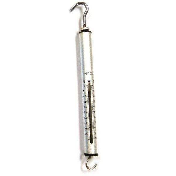

Have you considered a simple dynamometer attached to one end of the cable, with the other end anchored? Something like so:
PH0036A_88281dca-03aa-432c-88d8-445ae4b8c72f_1024x1024.jpe
Thanks for your reply. The force sensor I mentioned is essentially a electronic dynamometer.
Re: the multiple force vectors I can provide some more detail regarding this experiment. I am trying to measure the force that surgeons apply while knot tying to ligate delicate structures. Two ends of a suture are held, one in each hand, during knot tying. A skillful surgeon will maintain constant tension on one suture while the knot is tied with the other. I thought of tying knots directly onto the force sensor, but some surgeons apply a significant amount of tension in a plan orthogonal to the plane of the force sensor e.g. horizontal rather than vertical when the sensor is oriented along the vertical axis. I am looking for a method for measuring the tension no matter what direction the tension is applied.
