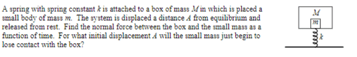

A spring with spring constant k is attached to a box of mass M in which is placed a small body of mass m. The system is displaced a distance A from equilibrium and released from rest. Find the normal force between the box and the small mass as a function of time. For what initial displacement A will the small mass just begin to lose contact with the box?
(Picture of the situation is attached if necessary.)

Alright, so I've stepped back and re-evaluated this problem from the beginning. I'm figuring that my issue mainly has to do with the way I've set up the coordinates here.
Let y = 0 be the relaxed position of the spring (i.e without any masses on it). Then, when the masses are added, the spring is displaced by -L. So, we have,
##\vec F_{spring} = -k \Delta \vec y = k \Delta \vec L##
So, our net force at equilibrium would then be,
## F_y = k \Delta L - (m + M)g = 0##
##\Delta L = \frac {(m+M)g} k##
Then, if we consider the problem when the masses are accelerating upward,
##-k\Delta y - (m + M)g = (m+M)\ddot y##
##\Delta y = y - \Delta L##
It reduces down to the following, eliminating the gravitational force,
##-ky = (m+M)\ddot y##
This is a homogeneous differential equation now, and the solution simply is,
##y(t) = A\cos{ω_ot}##
Where A is the initial amplitude given in the problem statement. From Newton's 2nd Law on m,
##n - mg = m\ddot y##
##n(t) = m(g - {ω_o}^2A\cos{ω_ot})##
For the initial displacement A such that n vanishes, we find,
##0 = m(g - {ω_o}^2A)##
##A = \frac g {{ω_o}^2}##
How's this look?
Luxucs said:
How's this look?
Looks right.
