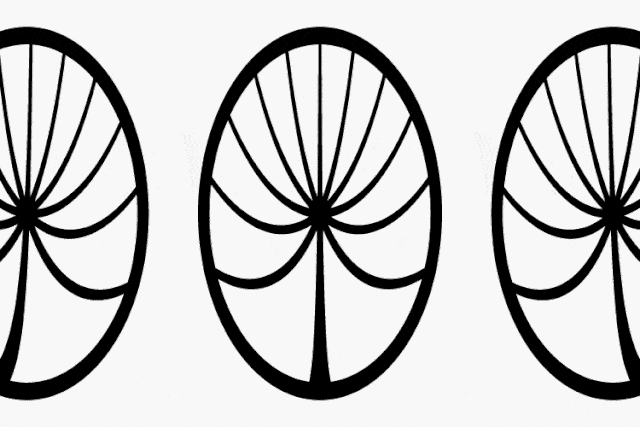

But here is a scenario in which I don't see how the physical predictions could be the same. What am I getting wrong? How are the below scenarios equivalent?
1. Standard SR. A sphere is rotating at a very fast angular velocity (hypothetical scenario). An observer in the same frame who is not rotating will see it as shrunk. But it will keep its spherical form.
2. Non-standard SR (call it LR) with light speed being isotropic only in one absolute frame. The sphere rotates at angular velocity w. It is not located in the absolute frame, so some parts will have the speed v + w, others v - w. Thus, the sphere will have an egg shape, because the part moving at speed v + w momentarily will contract more than the one with v - w (iff we take the degree of contraction to be proportional to the speed, as Lorentz did).
Therefore, in a world where an alternative interpretation to that of Einstein is adopted the fast moving spheres will be seen egg-shaped in any frame other than the absolute one.

It does contract more on one side than the other, but this renders the object eliptical shaped, not egg shaped, same as a non-rotating circle at high velocity. Here's an image that illustrates it
This is essentially a wheel rolling (at v, more than half light speed) on a stationary surface. The bottom isn't moving at all, but top is barely moving faster than v. The shape of the wheel is an ellipse.
Viewed in its own frame, the same wheel is circular and has straight spokes, and its physical circumference (measured by a tape measure rotating with it) is considerably greater than 2πR but is contracted down to 2πR due to its speed. The wheel cannot be stopped without stretching or breaking its spokes.

I think @alexandrinushka is asking about the view from the rest frame of the wheel/sphere, whereas you are talking about the frame where the wheel/sphere is moving.
Ibix said:
Lorentz ether theory has the same clock synchronisation complexities vanilla SR has. From the "absolute" frame there is a different time difference between the position measurements of leading and trailing ends of the ##v\pm\omega r## parts of the sphere. This exactly cancels the difference in the length contractions so the frame comoving with the sphere sees the same length contraction of both.
Yes, I think you got the exact scenario, which I am not really managing to explain very well.
Observer A is moving at speed v compared to the supposedly absolute frame. Sphere B is also moving at the same speed and direction as A. I am supposing A and B are contracting at the same degree. Now B starts spinning. I am aware the centrifugal forces are making it larger, but let's ignore this.
Since the part of the sphere moving at the "absolute" speed v + w is contracting more than B before rotation and the part moving at "absolute" speed v - w is contracting less, I am supposing it will get an egg shape.
So... if I get you right, because of synchronization issues, observer A will still see just a diminished sphere and no egg?

It is more than that. Even if you hypothesize an "unobtainium" that is strong enough to not be torn apart, there is simply no Born rigid angular acceleration. Such motion does not exist, regardless of the material.
My recommendation is to simply describe the final state and shape of rotation, without any attempt to link it to the initial shape. Once you have specified that in one frame, then you can describe it in other frames with a Lorentz transform. That Lorentz transform is identical for LR and SR, so the resulting boosted shape will be identical in both.

Perhaps it's easier to ask, if I see two identical rods moving in opposite directions at the same speed, but I'm moving in the Lorentz ether frame, why don't I see the rods as different lengths since they have different speeds in the ether frame. That gets rid of the complexities of spin and keeps what I think is the gist of the question.
The point is that the rods are moving, so to measure the length I need to measure the positions at the same time. If I don't, I get the length plus or minus the velocity times the time difference. But my clocks are desynchronised as viewed from the ether frame, so from that frame I'm not correctly measuring the length. And my failure will be different for each rod, in a way that exactly cancels the difference in length due to the length contraction.
This is exactly the same explanation vanilla SR gives for why moving instruments give measurements as if they were at rest. The only difference is that vanilla SR takes the principle of relativity as an assumption while in Lorentz Ether Theory it emerges from the Lorentz transforms. Don't ask me what the basic assumptions of LET are, though!
