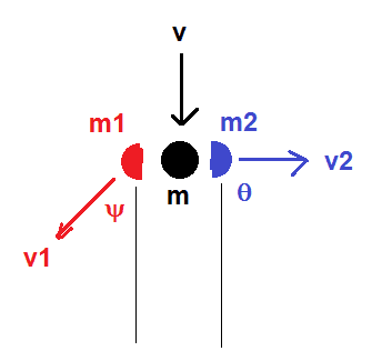

You have equations both for the vertical and horizontal components of the momenta. What are they? See picture.
Diagram of a black ball of mass m moving downward with velocity v, splitting into two pieces: m1 (red) moving down-left at angle psi with v1, and m2 (blue) moving right at angle theta with v2.

You need to get the momenta for both pieces, and determine the individual kinetic energies. Add them, and add E.
