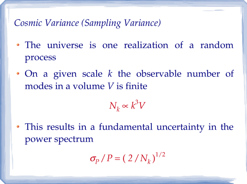

Hello,
I would like to know the right expression for the expression of variance of Shot noise in spectroscopic probe.
Sometimes, I saw ##\sigma_{SN,sp}^{2} = 1/n_{sp}## with ##n_{sp}## the average density of galaxies, whereas my tutor tells me that ##\sigma_{SN,sp}^{2} = 1/n_{sp}^{2}## , so I would like to know the right expression and a demonstration if possible.
For example, I show you a slide, from Nico Hamaus, a pseudo or correct demonstration of spectroscopic Shot Noise :

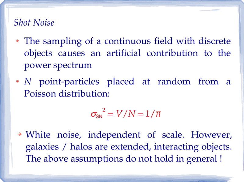

and the infered expression for Shot Noise spectroscopic :
As you can see on this second slide, we have for the variance : ##\sigma_{sn}^{2}=1/\bar{n}_{sp}## (and not squared like my tutor told me).
Any clarification is welcome (ideally, a demonstration like on these slides would be great). There are not a lot of documentation on the net for this quantity "Shot noise spectroscopic" and its mean, variance.
Best regards

I would say not squared. At low N the distribution is a time sequence Poisson and at high N it becomes Gaussian.
