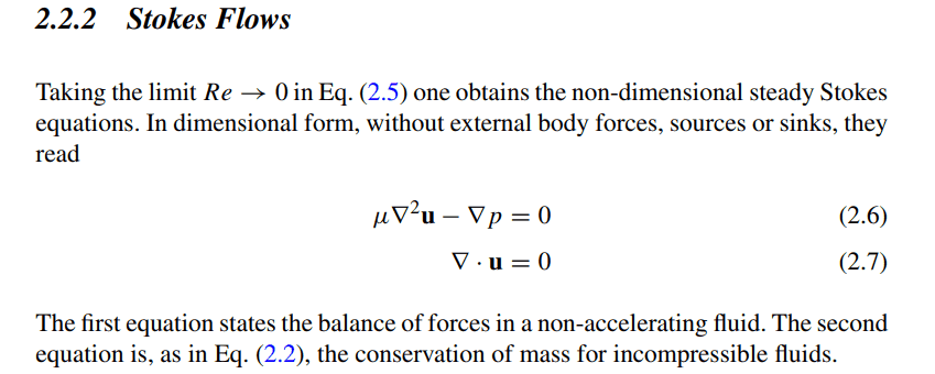

find the appropiate Navier-Stokes equation in the low Re number limit
Navier Stokes equations
in the limit as Re→0 , we can neglect the material derivate of v ( Dv/Dt =0 ) but why in books they always make the gravity effects equal to 0?
i can't understand and no one really explains this stuff
The density is being treated as constant, so the gravational force per unit mass is \mathbf{g} = -\nabla\left(-\int\mathbf{g} \cdot d\mathbf{x}\right).
You can therefore absorb it into the pressure term. It makes no difference to the mathematics if you work with p or p' = p - \int\mathbf{g} \cdot d\mathbf{x}.
yeah, that's the so called "modified pressure" right? i hardly managed to get that but still almost no source of information talks about that...
