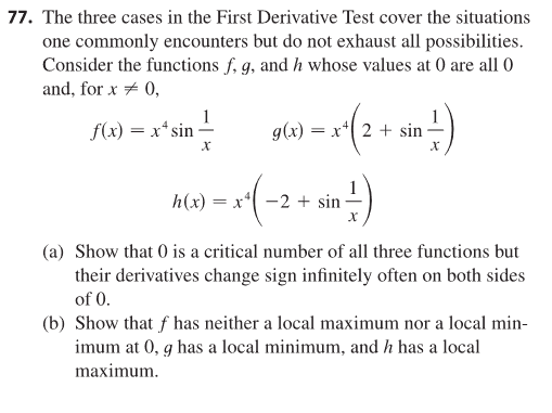

Consider the function ##f(x) = x^4 \sin(\frac 1 x)## for ##x \ne 0## and ##f(x) = 0## for ##x =0##. I have to prove that ##x=0## is the critical number of this function and its derivative changes the sign indefinitely.
Definition of the critical number
##x=0## would be the critical number if ##f'(0) = 0## or if ##f'(0)## does not exist. I have been able to show that ##f'(0) = 0## using the squeeze theorem. Now I want to show that the derivative of ##f(x)## changes sign indefinitely. I am totally stuck at this point. How would I progress from here ?

Maybe you are misinterpreting what the problem is asking for. If it says "show ..." rather than "prove ..." a less rigorous explanation is called for. Can you post a picture of the problem statement?
Ok, I am putting snapshot of the problem.
So I will present the proof here. Consider a sequence ##x_n = \frac{2}{\pi(2n-1)}## where ##n\in\mathbb{N}##. Then we have a subsequence ##x_{n_1} = \frac{2}{\pi(4n_1 - 3)}##, such that ##f'(x_{n_1}) = \frac{32}{\pi^3(4n_1-3)^3} >0## for all ##n_1 \in \mathbb{N}## and we have another subsequence ##x_{n_2} = \frac{2}{\pi(4n_2 - 1)}## such that ##f'(x_{n_2}) = \frac{-32}{\pi^3(4n_2-1)^3} <0## for all ##n_2 \in \mathbb{N}##. So this proves that, the derivative changes sign infinitely often. I hope this is correct.
I also have to prove that ##f## has neither a local maximum nor a local minimum at ##0##. Here I present my proof. Suppose ##f## has a local maxima at ##x=0##. Then we have some open interval ##(a,b)## containing ##x=0## such that ##f(x)\leqslant f(0)##, for all ##x \in (a,b)##. This implies ##f(x) \leqslant 0##, for all ##x \in (a,b)##. Now ##a<0<b##. By Archimedean Property, there exists ##n_1 \in \mathbb{N}## such that ##\frac 1 n_1 < \frac{\pi b}{2}##. But we have ##4n_1-3 \geqslant n_1 >0##, which implies that ##\frac{1}{4n_1-3} < \frac{\pi b}{2}##. Hence we have ##0< \frac{2}{\pi(4n_1-3)} < b##. So ##\frac{2}{\pi(4n_1-3)} \in (a,b)##. This leads us to ##f\left(\frac{2}{\pi(4n_1-3)}\right) \leqslant 0##. But ##\forall n_1 \in \mathbb{N}##, we have ## f\left(\frac{2}{\pi(4n_1-3)}\right) = \frac{16}{\pi^4(4n_1-3)^4} > 0##. So we reach a contradiction. Hence ##f## doesn't have a local maxima at ##x=0##. Now suppose that ##f## has a local minima at ##x=0##. Again, there exists an open interval ##(a,b)## containing ##x=0## such that ##f(0)\leqslant f(x)##, for all ##x \in (a,b)##. Since we have ##a<0<b##, we can come up with some ##n_2 \in \mathbb{N}##, due to Archimedean property, such that ##\frac 1 n_2 < \frac{\pi b}{2}##. But ##(4n_2-1) > n_2 > 0##, so we get ##\frac{1}{4n_2-1} < \frac{\pi b}{2}##. So ##0< \frac{2}{\pi(4n_2-1)} < b##. This means that ##\frac{2}{\pi(4n_2-1)} \in (a,b)##. Because of our assumption, this means that ##f\left(\frac{2}{\pi(4n_2-1)}\right) \geqslant 0##. But ##\forall n_2 \in \mathbb{N}##, we have that ##f\left(\frac{2}{\pi(4n_2-1)}\right) = \frac{-16}{\pi^4(4n_2-1)^4} < 0##. So again we reach a contradiction, which means that ##f## can not have a local minima at ##x=0##. I hope my proof is correct.
