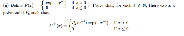

Please see below
Please see below
For this problem,
Handwritten-style math: part (ii) defines F(x) as exp(-x^-1) for x > 0 and 0 for x ≤ 0, then asks to prove for each k in N a polynomial P_k exists with F^(k)(x) = P_k(x^-1) exp(-x^-1) for x > 0 and 0 for x ≤ 0.
My solution is,
##F(x)=\left\{\begin{array}{ll} e^{-\frac{1}{x}} & \text { if } x>0 \\ 0 & \text { if } x \leq 0\end{array}\right.##
The we differentiate both sub-function of the piecewise function. Note I assume differentiable since we are proving a result that the function is differentiable, so I assume that ##F^{k}(0)## exists, that is the function is k-differentiable at zero assuming the limit exists. I will prove for first derivative k = 1 below.
##F'(x)=\left\{\begin{array}{ll} -\frac{1}{x}e^{-\frac{1}{x}} & \text { if } x>0 \\ 0 & \text { if } x \leq 0\end{array}\right.##
##F''(x)=\left\{\begin{array}{ll} \frac{1}{x^2}e^{-\frac{1}{x}} & \text { if } x>0 \\ 0 & \text { if } x \leq 0\end{array}\right.##
One can continue considering ##k## number of cases
Thus from our proof, the polynomial ##P_k## can be written explicitly as ##P_k = \frac{1}{x^{k - 1}(-1)^k}## for ##k > 0##
Thus we consider two cases for ##k##,
F^{(k)}(x)= \begin{cases}\frac{1}{x^{k - 1}(-1)^k}\left(x^{-1}\right) \exp \left(-x^{-1}\right) & \text { if } x>0 \\ 0 & \text { if } x \leq 0\end{cases}
for ##k > 0##
And for ##k = 0##, we have the original piece wise function,
##F(x)=\left\{\begin{array}{ll} \exp \left(-x^{-1}\right) & \text { if } x>0 \\ 0 & \text { if } x \leq 0\end{array}\right.##
QED
So as part of our proof, we also consider a sub-proof of the reason why the function is ##F^{k}## at ##x = 0##. We just consider the trival case for ##k = 1##,
In order to be differentiable at zero then ##lim_{x \to 0} F(x)## must exist. This is equivalent to both the Left hand and right hand limits existing.
##\lim_{x \to 0^-} F(x) = \lim_{x \to 0^-} 0 = 0##. Therefore, left hand limit exists.
Now for right hand limit, we have,
##\lim_{x \to 0^+} e^{-\frac{1}{x}}## DNE as I don't know the limit as ##\frac{1}{x}## goes to zero. However, for some reason, wolfram alpha says that ##\lim_{x \to 0^+} e^{-\frac{1}{x}} = 0##. Does someone please know why this is true?
I will assume that that is true, and I think the next part of the sub-proof is to generalize to higher order derivative
In order to find ##F^{k}(0)## then this limit ##\lim_{x \to 0} F^{k}## must exist.
That is, ##\lim_{x \to 0^-} F^{k}(x) = \lim_{x \to 0^+} F^{k}(x)##
##\lim_{x \to 0^-} F^{k}(x) = \lim_{x \to 0^-} 0 = 0##
##\lim_{x \to 0^+} F^{k}(x) = \lim_{x \to 0^+} \frac{1}{x^k(-1)^k}e^{-\frac{1}{x}} = \frac{1}{(-1)^k}\lim_{x \to 0^+} \frac{1}{x^k}e^{-\frac{1}{x}} = 0##
Does someone also please know whether this a proof by induction (or what sort of proof it is)? Or can we just use a informal generalization proof?
Thanks!

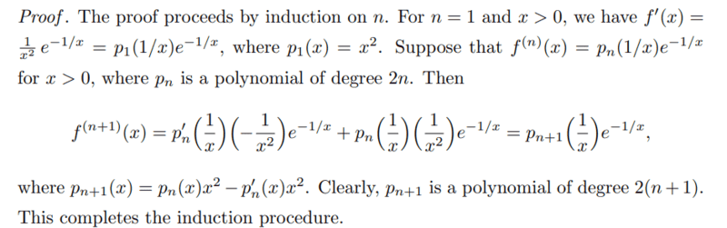

Thank you for your reply @docnet! I have some question about this solution,
Typeset proof by induction on n: f'(x) = (1/x^2) e^(-1/x) = p_1(1/x) e^(-1/x) with p_1(x) = x^2, then the inductive step computing f^(n+1)(x) using the product rule and the recurrence p_(n+1)(x) = p_n(x) x^2 - p_n'(x) x^2, a polynomial of degree 2(n+1).
Do you please know how they go from the ##f^{n}(x)## to ##f^{n + 1}(x)## step (I assume they differentiate ##f^{n}(x)##)? I think they made a typo there is something because they did not seem to differentiate the ##\frac{1}{x}## since it is three functions multiplied together so you have to use the product rule on ##p_nu## where ##u = \frac{1}{x}e^{-\frac{1}{x}}##.
I also don't understand how they got ##p_1(x) = x^2##. Should it not be ##p_1(x) = \frac{1}{x}##?
Thanks!

Let's take your last question first.
There is no way that ##\displaystyle \ p_1(x) = \frac{1}{x} \ ##. Fir one thing, that's not a polynomial at all.
If as they say, ##\displaystyle \ p_1(x) = x^2 \ , \ ## that then says that ##\displaystyle \ p_1\left( \frac 1 x \right) = \left( \frac 1 x \right)^2 \ , \ ##
Perhaps you're still having difficulties with ##\displaystyle \ F\,'(x) \ .\ ## As @docnet already told you:
docnet said:
Please remind yourself of the correct definition of the chain rule ##\frac{d}{dx}f(g(x))=f'(g(x))g'(x)## and re-check your work for $$\frac{d}{dx}e^{-1/x}.$$
So, no, ##\displaystyle \ p_1\left( \dfrac 1 x \right) \ne \frac{1}{x} \ ## because ##\displaystyle \ \frac{d}{dx}e^{-1/x}\ne
\frac{1}{x}e^{-1/x} \ .##
As for differentiating ##\displaystyle F^{(n)}(x)\,, \ ## it is the product of only two functions, not three. Note that the chain rule is involved in differentiating each of those two component functions.
Yes, differentiating ##f^n(x)## is a crucial step of the induction procedure.
Thanks!
##p_n\left(\frac{1}{x}\right)## indicates ##p_n## is a function of ##\frac{1}{x}##, like how ##f(x)## indicates ##f## is a function of ##x##.
You should have ##p_1=\frac{1}{x^2}## because $$\frac{d}{dx}e^{-x}=\frac{1}{x^2}e^{-x}.$$
##\frac{1}{x^2}## isn't a polynomial but ##x^2## is one. It's true that
$$p_1\left(\frac{1}{x}\right)=\frac{1}{x^2}\Longleftrightarrow p_1(x)=x^2.$$
