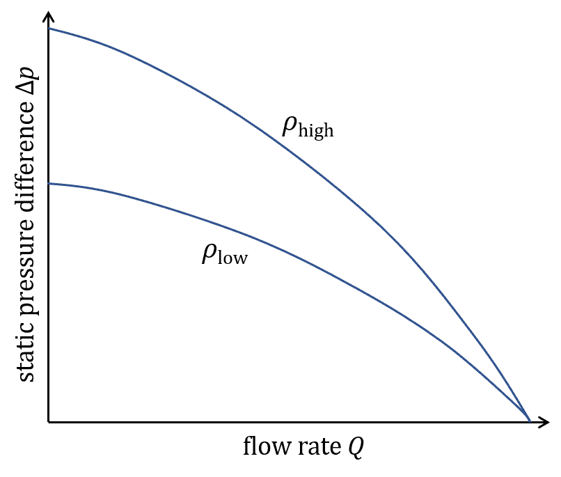

I'm working on a test method for the performance rating of range hoods. For the same device the test should give the same result in any laboratory. The laboratories can be located at different altitudes and thus they test under different air densities. One part of the test is to measure the fan curve (flow rate vs pressure). The test is done at the highest speed setting by selecting the highest level on the display panel. Usually, the number of the level does not have any units but is just representative for the "intensity" of the speed setting. I was told (and read online) that a higher air density will lead to a proportionate higher pressure difference and to a proportionate higher power input. The flow rate is supposed to remain unaffected. An example of a fan curve for this scenario is shown below. Now the laboratory should simply measure the air density during the test and adjust their measured fan curve to a fan curve that would have been measured during reference air density. For example, if the air density during the test was twice as high as the reference air density, then the pressure of every measured point on the fan curve is divided by two to get the reference fan curve. The calculated reference fan curve is supposed to be the same no matter where the measurement was done.
However, I wondered if there could be range hoods on the market where the electric motor does not simply double the power input in order to double the pressure if the air density is doubled. If there were electric motors that decrease their rpm because of the heavier load, the suggested calculation to "how the fan curve would look like during reference air density" would be wrong.

First thing, not all fans are the same, whether or not they maintain their rotating speed would heavily depend on what type of electric machine, what is controlling the machine etc etc. I will assume since you are talking about range hoods, its a single phase induction machine squirrel cage style blower, unlikely they would use a universal motor here due to brush life issues.
I would say generally there is no speed control happening in most range fans. But... Most line connected fans are running single phase induction machines, these are asynchronous, that is they are not locked exactly to the electrical frequency. But their output torque is linked to the difference between their rotating speed and the line frequency, this is known as slip. So an unloaded 2 pole induction machine running from 60Hz will rotate at very slightly below 3600rpm. Since an induction machine builds the rotor magnetic field by induced currents in the rotor generated by the difference between rotor rotation speed and the rotating field in the stator (locked at the driving frequency, ie 60Hz in this case), as load is applied to the fan it must slow a little bit to generate the required field to produce torque.
So in short a single phase induction machine is not exactly constant speed, but it does not change speed by that much as it is loaded (unless overloaded!), slip is in the range of 1% or so for large machines, more like 5-10% for smaller machines.
Eg this blower motor (note loaded rpm is 3400rpm, ie ~6% slip):
So as the fan is loaded, the machine will slow a little, but not much.
Even if machine speed is constant, air density, pressure, humidity etc will have a large impact on flow rates. Which is why any standard or test specification worth talking about will list the environmental conditions required to repeat the test, eg ambient temp, humidity, elevation etc etc.
