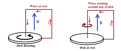

There is no meaning to absolute rotation of the disk. As Paul Colby points out in post #20, the return path must also be considered.
Here is a video that shows various cases of parts of the setup moving relative to other parts.
The demo starts at time 0:30
Thanks for the video. Case #5 was interesting. However this does not lead to the conclusion that there is no meaning to the absolute rotation of the disk. Case #5 generates a voltage because the upper part of the stator is moving through the magnetic field and the strength of this field is less at this point than it is near the path between the electrodes on the disk.
The following two cases produce the same emf:
(1) Rotate the disk at 10 rad/s with respect to the lab while keeping the stator and external parts of the circuit at rest relative to the lab.
(2) Keep the disk at rest with respect to the lab while rotating the stator and external parts of the circuit at 10 rad/s in the opposite direction relative to the lab.
If you rotate both the disk and the external circuit in the same direction at the same angular speed, no current is induced.
So, it's not absolute rotation of the disk that matters. What matters is the relative motion of the disk with respect to the external circuit. At least that's how I see it.

Hi. For our discussion I would write down below the table of rotation experiment results.
(d,c,m)=
(s,s,s)=0
(r,s,s)=1
(s,r,s)=1
(r,r,s)=0
(s,s,r)=0
(r,s,r)=1
(s,r,r)=1
(r,r,r)=0
where
d : the disk
c : the circuit other than the disk
m : the magnet
s : still
r : rotate in an amount
(d,c,m) = 0 no emf, 1 emf.
Relative rotation of the disk and other part of the circuit matters. Rotation of magnet has nothing to do with it in non relativistic theory at least. Best.

TSny said:
No, I wasn't kidding.
But I think I must be misinterpreting what you mean by "absolute rotation of the disk". Does that mean rotation "relative to the fixed stars" as in Newton's rotating bucket experiment?
More accurately, an object is considered rotating if it experiences rotational forces (proper acceleration due to rotation). If the disk experiences these forces than I call this absolute rotation but it is probably more proper to say a disk is rotating if its angular velocity is > 0.
But we know that a current can be generated when the disk is not experiencing rotational forces if we rotate the external wires of the circuit instead of rotating the disk.
Two diagrams of Faraday's disk: left, the disk rotates with wires at rest and a magnetic field B pointing up; right, the disk is at rest while the wires rotate around its axis, with B pointing up.
But, if I understand some of your previous remarks, you are not claiming that the circular disk must have absolute rotation. You are claiming that some part of the apparatus must have absolute rotation. So, in the picture on the left, it would be the disk that has absolute rotation while in the picture on the right it is the wires that have absolute rotation. But how could you prove that it's absolute rotation that matters, rather than relative motion of the disk and wires?
Because the disk has no effect on the wires. Move two parallel wires past each other in a magnetic field and each wire experiences forces only because of each wire and the field, not because you have two wires going past each other.

Thanks TSny for post #55 that suggests to improve my post #46 , with signature to mention the direction of emf, i.e.
(d,c,m)
(s,s,s)=0
(r,s,s)=+1
(s,r,s)=-1
(r,r,s)=0
(s,s,r)=0
(r,s,r)=+1
(s,r,r)=-1
(r,r,r)=0
