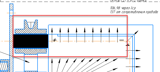

  • #61
renormalize said:

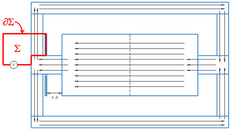

This statement contradicts Maxwell's equations. Per your post #56, your external circuit forms a closed path I label as ##\partial\Sigma##, which is the boundary of an enclosed surface that I denote as ##\Sigma##:
You declare that your magnetic shield is designed to entirely contain the magnetic field and prevent it from anywhere entering the area ##\Sigma## of the circuit. But the Maxwell-Faraday equation states that the electromotive force ##\mathcal{E}## around the path ##\partial\Sigma\,##, which is what your voltmeter will register, is given by:$$\mathcal{E}=\oint_{\partial\Sigma}\vec{E}\cdot d\vec{l}=-\frac{d}{dt}\int\!\!\!\int_{\Sigma}\vec{B}\cdot d\vec{S}$$Since there is no normal-component of ##\vec{B}##, nor indeed any magnetic-field component at all, on the surface ##\Sigma\,##, the EMF ##\mathcal{E}=0## and your moving circuit will show zero voltage and generate no current whatsoever.
Please excuse me for the poor-quality model. Actually, it's not a shielding disk. This part is called a current plate. It is electrically isolated from the generator. I have drawn the path of the electric current with an intermittent line. In this model, the moving external circuit is a short section A-B. In the practical design of the generator, I made this circuit in the form of carbon brushes that pass through the pulley and rotate with it. I assume that instead of brushes, you can use a liquid conductor, such as mercury, which will rotate inside an annular channel with a rectangular cross-section.
  • #62
Thanks for the clarification, but that still begs the question: is there any component of the magnetic-field that is both nonzero within, and normal to, the area enclosed by the dashed orange line that is the closed path of the circuit? If not, Faraday's law of induction states that there can be no EMF and no current.
  • #63
I imagine the distribution of the magnetic field in the core of the generator to be something like this. I made an air gap in the generator core and non-gap surfaces (highlighted in red). It turns out that the external circuit in any case moves perpendicular to the lines of force of the magnetic field. In essence, the core of the generator is a disk, the edges of which are folded to the axis like an umbrella. I have indicated the orange line more precisely, as I imagine.

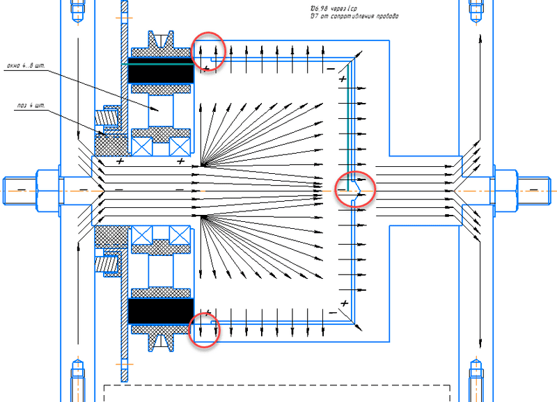

  • #64
Then there is no magnetic-field component normal to the surface ##\Sigma## bounded by the orange path and the magnetic flux ##\Phi_{\Sigma}=\int\!\!\!\int_{\Sigma}\vec{B}\cdot d\vec{S}## through that surface is zero. Hence there is no EMF and no current. By Faraday's law of induction, you must have a nonzero, time-dependent flux through ##\Sigma## (i.e., ##\dot{\Phi}_{\Sigma}\left(t\right)\neq0##) in order to develop an EMF around the orange path.
  • #65

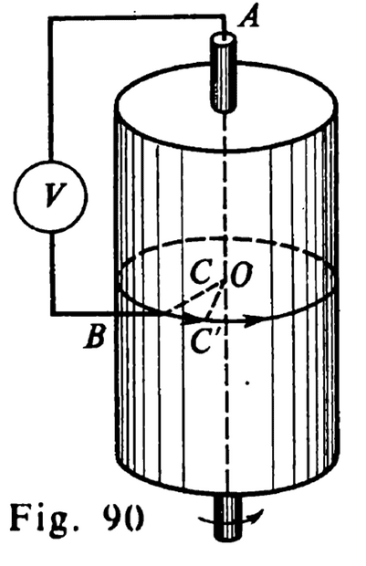

It is possible that your question can be answered as follows. In Tamm's book "Fundamentals of the Theory of Electricity", the rule for calculating the electromotive force for contours, which opens during movement, is considered. The picture shows a model for such a case. The book claims that when calculating the flow change, the flow through the closed contour C'OAVBCC' is applied. This contour is obtained when contour C'OAVBC is deformed using a segment of the trajectory CC' along which the contour break point C' moves.
As I understand it, contours are breaking in my generator and the circular sector COC' must be taken into account to calculate the electromotive force. In addition, it is not yet clear to me what is the fundamental difference between the geometry of the magnetic field of my generator and the Faraday disk? In the drawing, I have depicted a part of the generator and a part of the Faraday disk. In both cases, the external chain moves inside the sheet. It seems to me that the configuration of the magnetic field and the velocity vector is the same in both cases.
  • #66
As I imagine, if the external circuit moves inside the sheet, it should detect something like this electric field pattern - the entire inner surface of the magnetic circuit is positively charged, and the entire outer surface of the magnetic circuit and the axis are negatively charged. It seems to me that the same process is obtained if an observer (a blue ball) flies through a toroid with a closed magnetic field. Therefore, if the entire inner surface of the magnetic circuit is positively charged, then the outer circuit will be in contact with an electric field.
  • #67

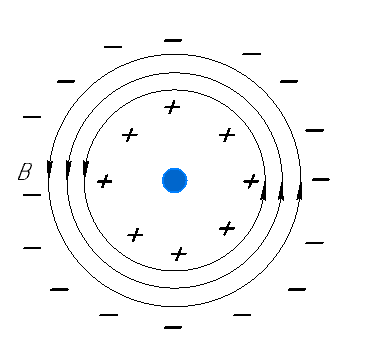

Yes, that's right. The rotating external electrical circuit has sliding contacts (carbon brushes), which are installed at the boundary of the magnetic field.
Brushes cannot be installed outside the boundaries of the magnetic field. At least one brush must be installed directly at the edge of the magnetic field of the disc.
This may seem paradoxical, but my experiments confirm it. I believe that this phenomenon can be explained as follows.
An observer located in an external circuit detects an electric field directly at the boundaries of the magnetic field. At the same time, the observer located in the disk does not detect any electric field. That is, this electric field exists only for a moving external circuit. In order for the electric field to enter the external circuit, it must be in direct contact with at least one brush. If the brushes are located at some distance from the observed electric field, despite the fact that they are attached to the metal of the disc, the electric field does not reach them, since this field does not exist for the disc and it does not conduct it. This is a very important point to consider when designing.
I would like to consider this issue in more detail. I have analyzed the results of experiments over several years and have come to the following conclusion. In models where the brushes are located at some distance from the boundary of the magnetic field (and the observed E-field), the electromotive force is not observed. I even introduced a special term: "inert conductor" to denote the part of the circuit between the boundary of the M-field and the brush.
In fact, this phenomenon is explained as follows. It is important to understand that the electric field that is detected by a moving observer is by its nature an electrostatic field. That is, the electric fields in the Faraday disk and in most modern electric machines are inherently different.
The figure shows a metal conductor located in an electrostatic field. Under the influence of this field, the charges of the conductor are distributed in such a way that the electric field inside the conductor completely compensates for the external field. Thus, the electric field detected by a moving observer within the boundaries of the magnetic field is completely compensated by the internal E-field of the conductor (in our case, the disk). As a result, the observed electric field does not extend beyond the part of the conductor that is in the magnetic field. This is how the absence of an electromotive force can be explained if the brushes are installed outside the boundaries of the magnetic field.

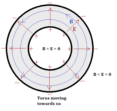

  • #68

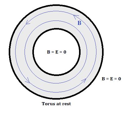

When the toroid is at rest, there is no electric field anywhere and the magnetic field is confined to its interior.
Now, suppose we move toward the toroid. In our frame of reference, the toroid is moving out of the page towards us. In our frame, the toroid has surface charge as you indicated. There will exist both electric and magnetic fields inside the toroid. But there will still not be any B or E field outside the toroid. In our frame, a free charge carrier inside the toroid experiences a magnetic force and an electric force. The two forces cancel so that the charge carrier is in equilibrium.
Is this how you see it also?

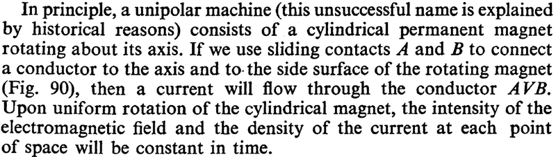

  • #69
Tamm says:
So the cylinder in Fig. 90 is a permanent magnet similar to the one shown at right and thus it contains a nearly-uniform, vertical magnetic-field ##\vec{B}## inside. Note therefore that the moving closed current-path has segments ##C,C'## inside of, and orthogonal to, the field ##\vec{B}##. Consequently, an EMF develops in the circuit and registers on the voltmeter. That's the fundamental difference: Fig. 90 has a current path partly inside the strong magnetic-field region, whereas you declare that your moving current path is entirely outside of the field. If that's truely the case, you will see no EMF nor current. Think about the situation this way: unless there is at least some portion of your moving current-path immersed inside the field ##\vec{B}##, there can be no Lorentz force ##q\,\vec{v}\times\vec{B}## to drive electrons around the circuit as a current.
  • #70
renormalize said:
Tamm says:
View attachment 357200View attachment 357201
Thanks for the detailed explanation. As I understand it, my generator also has sections of an electrical circuit similar to OC and OC', that is, part of the electrical circuit passes inside a magnetic core, that is, in a magnetic field. In this case, only the external circuit physically rotates, followed by the OC section, which is essentially a current path. Thus, taking into account the small differences in geometry, my generator is an analog of the model in Figure 90.

Спасибо за интересное объяснение и иллюстрации. Да, вы правы, я понимаю процесс именно так, как вы описали. Наблюдаемое электрическое поле всегда находится в границах магнитного поля, то есть в данном случае электрическое поле будет находиться внутри тора.
The generator can be equivalently represented as a torus. The external circuit moves inside it in a circle, like a particle in a particle accelerator. In the figure below, a ring with a magnetic field is rolled into a ring in the vertical plane (the section of the torus is shown). The upper carbon brush (in black) is moving away from us, the lower carbon brush is moving towards us.
