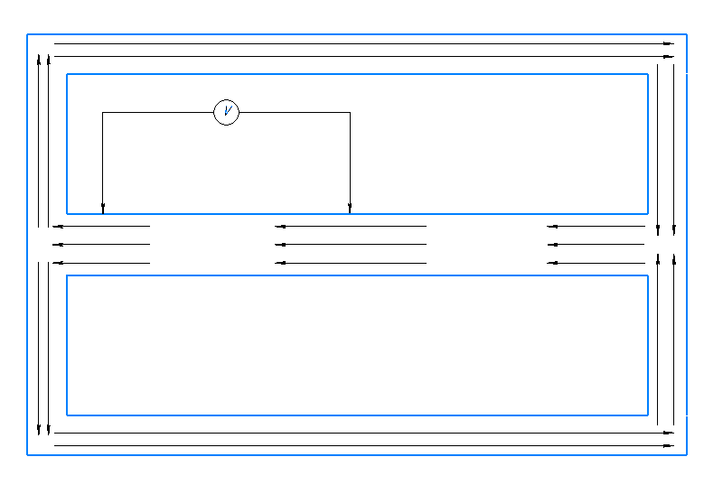

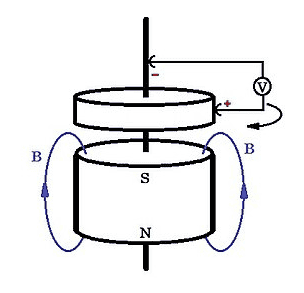

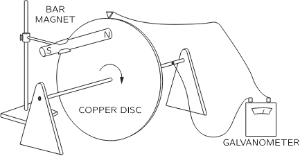

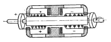

Good afternoon! I would like to understand how the Faraday disk works and get answers to two questions. The working conditions are as follows: 1) we rotate the external circuit with a voltmeter relative to a stationary disk; 2) the external circuit is not in a magnetic field. Questions: 1) will an electric current flow in such a system? 2) what forces will act on the external circuit with the voltmeter? I would like to consider these processes precisely from the point of view of the theory of relativity, since the Faraday disk is based on the principle of relativity of simultaneity. Thank you in advance!
On external circuit which does not include the disk, Lorentz force of v X B appears and makes electrons move where v is r##\omega##.

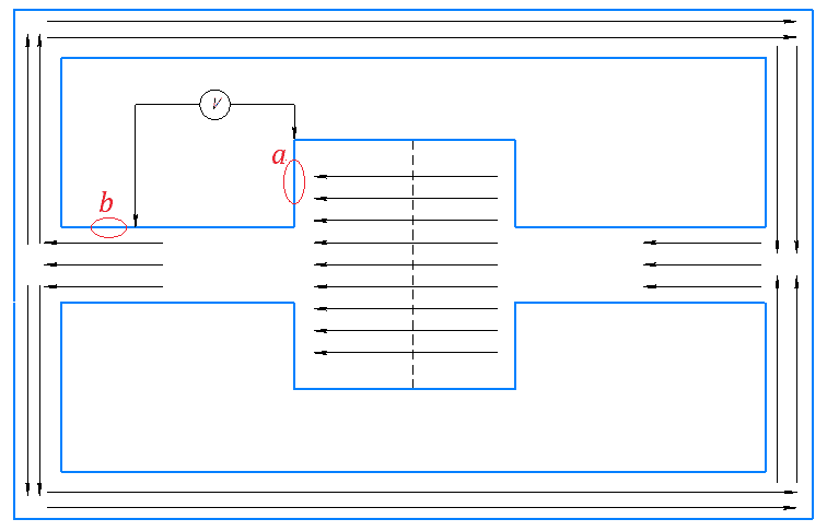

Here is an elaboration of @anuttarasammyak's comment.
By the "external circuit," I think you mean this part
This part of the circuit is in a magnetic field. The field of the magnet extends to this part.
Yes.
As the external circuit rotates in the direction shown in the figure, the free charge carriers in the external circuit move through the B field. So, a carrier with charge ##q## and velocity ##\mathbf v## experiences a magnetic force ##\mathbf F = q \mathbf v \times \mathbf B##. For simplicity, imagine the B field to be uniform:
In the horizontal parts ##ab## and ##cd##, the magnetic force on electrons is toward the axle: from ##b## toward ##a## and from ##c## toward ##d##. See this video for a discussion of the motional electromotive force (emf) induced in a rod rotating in a B field. Since ##ab## is longer than ##cd##, the emf in ##ab## is greater than in ##cd##. Thus, the net emf in the external circuit drives electrons in the external circuit in the counterclockwise direction: ##d## to ##c## to ##b## to ##a##. Electrons arriving at ##a## flow down the axle and back to ##d## through the stationary disk.

Thanks for the comment. Yes, you understand correctly which part of the system rotates. I would like to understand how this system will work if the external circuit is not in a magnetic field. Let's say that due to the design, we will make it so that the magnetic field bypasses the external circuit.

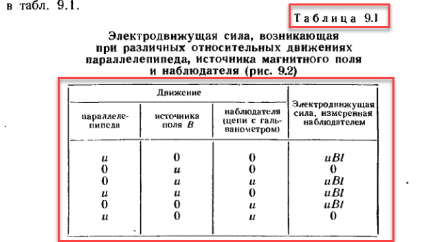

The following is stated in the literature: "An observer moving at a velocity u, relative to a medium with magnetization M, detects an electric moment P equal to:
At the same time, it is not claimed that the moving observer must be in a magnetic field. Based on this statement, we can give a slightly abstract example. A magnet with a conductive surface (a metal magnet) lies motionless on the table. A copper wire moves relative to the magnet, at a great distance from it and perpendicular to the magnetic field lines. An observer located in a copper wire detects an electric field on the sides of the magnet. If a copper wire is connected by brushes to the sides of a magnet, current will flow in a closed circuit. At the same time, the copper wire is not in a magnetic field. Is this interpretation correct?

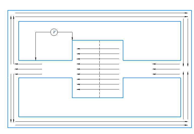

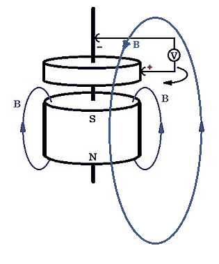

A magnetic field can be closed in addition to an external circuit, for example, like this.
Thanks for the comment. By the condition of the problem, the external circuit is not in a magnetic field, therefore the Lorentz force cannot appear.
Then apply B=0 to my comment, please. No B No emf.

Rotation of the circuit where B=0 and rotation of the disk where B##\neq## 0 should be investigated independently. You don't have to think of the correlation between.
There are three things; maget, disk and circuit. What kind of motion involving the three are you interested in ?

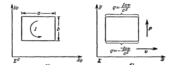

In the literature, the occurrence of electric polarization is explained as follows. It is argued that the magnetic field is a set of elementary circuits with an electric current. This refers to the rotation of an electron around an atom. It is argued that an elementary circuit with an electric current at rest in the reference frame S0 acquires an electric moment in the moving reference frame S. In a simplified way, this is explained as follows. For a moving observer, the time of movement of an electron in the direction of motion differs from the time of movement of an electron in the opposite direction. At the same time, it is not claimed that the moving reference frame S should be in a magnetic field.

I am interested in the motion of the external circuit relative to the magnet and the disk (the magnet and the disk are one).
Then as said no B no emf.
Then it turns out that the rotation of the disk and the rotation of the external circuit are not equivalent. Why? How can this be explained from the point of view of the theory of relativity?
For example, such a model is given in the literature. The picture shows a metal band that moves inside an inductor, that is, in a magnetic field. At the edges of the tape, sliding contacts of an external circuit are connected, which is not in a magnetic field. In this model, the metal band and the external chain have a rectilinear uniform relative motion, that is, they represent inertial reference frames. So, in the general case, we cannot understand whether the tape is moving or the external circuit is moving. There is only a relative motion at which current flows. Therefore, if we move only the outer circuit, we will get the same result. Is this statement true?
In fact, the first question of the topic can be formulated as follows. An electric current circuit is fixed in the laboratory (reference frame S0). Relative to this circuit with an electric current and at a great distance from it, a material point (reference frame S) is moving. The material point is not located in a magnetic field. An observer located in the frame of reference S of a material point discovers that a circuit with an electric current has an electric moment:
I would like to get an answer to this question precisely in the context of the theory of relativity.

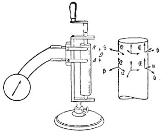

In this book, in chapter 22, the question of how applicable to rotation are the results obtained for rectilinear motion is discussed in detail. It is stated that for rotational and rectilinear motion are the same: 1) all the results concerning the possible variants of the relative motion of the magnetic field, the metal bar and the external circuit; 2) the electromagnetic process of production and the magnitude of the electromotive force. Thus, for my problem, rotation and rectilinear motion are equivalent.
In this book, in chapter 21, paragraph 178a, it is stated that the detection of an electric field when moving relative to a magnetic field, as well as the detection of a magnetic field when moving relative to an electric field, is a first-order relativistic effect that depends on u/c, and is a consequence of the relativity of simultaneity.

Based on literary sources, I came to the following conclusion. When the external circuit moves relative to the disk, an electric current must flow in the system. That is, the answer to the first question of the topic is in the affirmative. On the second question of the topic, about what forces will act on the external circuit in this case, I do not yet have an accurate understanding. Just speculation. Therefore, I wanted to address these issues on the forum and understand: 1) am I drawing the right conclusions on the first question; 2) get opinions on the second question.
Yes, as stated in post my #2 and @TSny ‘s #3 and also Panofsky Philips the figure of which you quoted in #19 with B there , but you said no B in #4. By which condition shall we go ?
