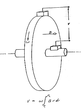

A Faraday Dynamo is used as a brake. The brushes are connected with an external resistance R_\Omega. The circular disk has mass m, and angular velocity \omega_0 when t = 0.
a) How long does it take until the kinetic energy of the disk is halved?
emf =\frac{B R^2 \omega}{2}
dW=P dt
P=\frac{(emf)^2}{R_\Omega}
I have no idea how to figure this problem out.
I've tried integrating dW from \frac{1}{2}m \omega^2_0 R^2 to \frac{1}{4}m \omega^2_0 R^2 setting that equal to the integral from t=0 to t of P dt (where I substitute P for the emf)
Looking at the answer, t=\frac{m R_\Omega ln(2)}{B^2 R^2}, I figured I need to integrate over \frac{1}{x}, in order to get the ln(2), but I've got no clue how to find that x. Any help much appriciated.
Using energy ideas, how is the rate of decrease of the KE of the disk related to the electrical power produced?

Note that ##\omega## decreases with time. So, the electrical power is not going to be constant. That means the link between electrical power P and KE must be written in terms of an instantaneous rate of change of KE (with care given to signs).
\frac{dKE}{dt}=-\frac{(\frac{B R^2 \omega}{2})^2}{R_\Omega}
Good. What if you express ##\omega^2## on the right side in terms of KE and moment of inertia ##\small I##? If you let K stand for KE, can you express the equation as follows? $$\frac{dK}{dt} = -b K$$
Here ##b## is a collection of constants.
Thank you so much! Here's what I got:
\frac{dK}{dt}=-\frac{B^2 R^4 \omega^2}{4 R_\Omega}=-\frac{B^2 R^2}{2 m R_\Omega}K, used that K=\frac{1}{2}m \omega^2 R^2
Solution for diff. equation: K=K_0 e^{-\frac{B^2 R^2}{2 m R_\Omega}t}
\frac{1}{2}=\frac{K}{K_0}=e^{-\frac{B^2 R^2}{2 m R_\Omega}t}
ln(\frac{1}{2})=-ln(2)=-\frac{B^2 R^2}{2 m R_\Omega}t
t=\frac{2 m R_\Omega ln(2)}{B^2 R^2}
But it's not quite right, there's a 2 here
Check this. ##K = \frac{1}{2}I\omega^2##. What is ##I## for a solid disk?
I=\frac{1}{2}m R^2, thank you so much!
