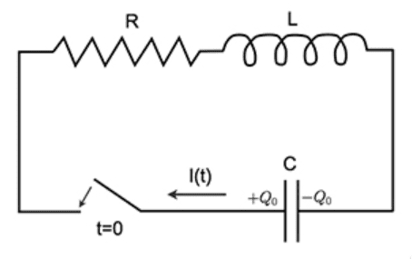

Consider the RLC circuit shown below. At ##t=0## the switch is closed.
a) For what values of ##R## will the initial sign of ##Q## be reversed at some later times?
b) Assuming the value of ##R## satisfies the condition in (a), find ##Q## and ##I## in terms of ##Q_0, R, L##, and ##C##.
c) If it takes 10 cycles for the energy in the circuit to decrease to ##e^{-1}## times its initial value, find the value of the resistance in terms of ##L## and ##C##.
Circuit schematic of a series RLC loop with resistor R, inductor L, and capacitor C with charges +Q0 and -Q0 on its plates, current I(t) shown, and a switch marked t=0.

zenterix said:
Using Faraday's law we have
$$\mathcal{E}=\oint\vec{E}\cdot d\vec{l}=\frac{Q}{C}+IR=-L\dot{I}\tag{1}$$
Check all of the signs in this equation. Which way around the circuit did you define the closed loop integral of ##\vec E##? Think about the direction of ##\vec E## between the capacitor plates and the direction of ##\vec E## inside the resistor.
zenterix said:
where ##I=\dot{Q}##.
The circuit diagram defines the direction of positive current and defines ##Q## as the charge on the left plate of the capacitor. From these definitions does ##I = \dot Q## or does ##I = -\dot Q##?
zenterix said:
$$\ddot{Q}+\frac{R}{L}\dot{Q}+\frac{1}{LC}Q=0\tag{2}$$
This equation looks correct.
You can simplify the calculations for parts (b) and (c) by noting that the switch is closed at time ##t = 0##. So, what is the value of ##I_0##?
At ##t = 0##, where is all of the electrical energy in the circuit? After one cycle, where is all of the remaining energy? After 10 cycles, where is the energy?
You are correct about there being a mistake in the signs. However, by luck the resulting differential equation is correct.
Here are the corrected calculations
$$\int_{capacitor}\vec{E}\cdot d\vec{l}=V_{C,before}-V_{C,after}=-\frac{Q}{C}$$
$$\int_{resistor}\vec{E}\cdot d\vec{l}=V_{R,before}-V_{R,after}=IR$$
However, we also have ##I=-\dot{Q}##.
Thus, Faraday's law should be
$$-\frac{Q}{C}+IR=-L\dot{I}$$
$$-L\dot{I}-IR+\frac{Q}{C}=0$$
$$-\dot{I}-\frac{R}{L}I+\frac{Q}{LC}=0$$
$$\ddot{Q}+\frac{R}{L}\dot{Q}+\frac{Q}{C}=0$$
Good.
zenterix said:
Indeed, ##I_0=0## simplifies the calculations.
In fact, after my OP I noticed this.
We find that
$$\tan{\phi}=\frac{R}{2L\omega}$$
$$Q(t)=e^{-\frac{\gamma t}{2}}Q_0(\cos{\omega t}+\frac{\gamma}{2\omega}\sin{\omega t})$$
$$I(t)=e^{-\frac{\gamma t}{2}}Q_0\left (-\frac{\omega_0^2}{\omega}\sin{\omega t}\right )$$
According to these equations, does ##I = -\dot Q##?

TSny said:
According to these equations, does I=−Q˙?
I forgot to add a minus sign to the entire expression.
I simply computed ##\dot{Q}## but ##I## is ##-\dot{Q}##.

zenterix said:
Ok, so if ##R\neq 0## then does equation (20) in the OP make sense?
If so then it gives the time for the energy to drop by ##e^{-1}##.
The integral in (20) gives the energy lost to heat. So, the left side should be the difference in the initial and final energies. If this correction is made, then the equation could be used, in principle, to find the time for the energy to drop by a factor of ##1/e##.
zenterix said:
The number of oscillations is then just the period, which is ##2\pi/\omega## divided by this time.
The other way around: The number of oscillations is the time ##t## divided by the period.
