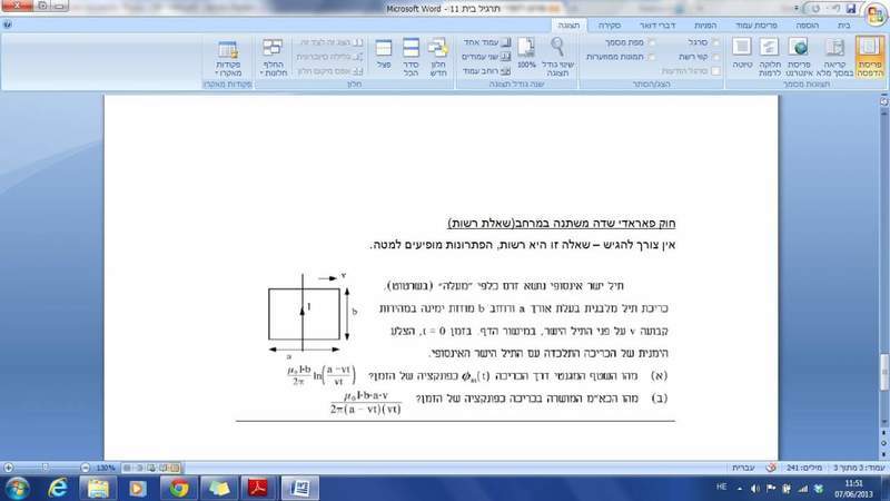

A straight infinitly long wire with a current of I upwards is stationary. A rectangular loop with length a and height b is moved to the right with constant speed of v across the wire in the plane of the paper. At t=0 the right edge of the loop is exactly at the same location of the wire.
What is the flux through the loop as a function of the time?
What is the induced emf as a function of the time?

Ok I tried something tell me if so far so good: I said that dA is in the out of the page direction:
For the flux in the left area:
∅L(t) = ∫[itex]\vec{B}[/itex]*[itex]\vec{dA}[/itex] = ∫μ0I/2∏r*dA*cos0 = μ0I/2∏∫[itex]\frac{1}{r}[/itex]dA
But dA=b*dr and r itself is a function of time, and at t=0 we get (with respect to the left edge of the loop) that r=a, and the final location of the left edge when we deal with the left side flux is r=0 and so:
∅L(t)=μ0Ib/2∏∫[itex]^{0}_{a}[/itex][itex]\frac{1}{r}[/itex]*-dr
-dr and not dr because r is getting smaller as the loop moves towards the wire.
How am I so far?
your integrand looks ok, but your limits are wrong
at each time t, you have to integrate across the whole loop
your "r" is the distance from the wire
if the wire is at position w(t) at time t,
then you have positive flux on the left from r = 0 to r = …
and negative flux on the right from r = 0 to r = … ? :wink:
(btw, once you've found what the limits are, there's a fairly obvious way of simplifying the integral)

well I guess you meant to write r(t) and not w(t) - I think that if r=0 is the location of the wire then r=a-vt is the location at t=0, and for the right part we go from r=0 to r=vt?
no, you're confusing r(t), which is a function of t and is the position of the wire is at time t
with r(x,t), the distance of a general point x (0 ≤ x ≤ a) from the wire
since your flux formula already uses r for the second one, I've used w(t) for the first one, and r(x,t) = |x - w(t)| for the second one :wink:
(now, to find the flux at time t, integrate over x, with t constant)

I'll write my calculations here briefly and I'll be happy if you'll give me your feedback. Thanks a lot!
Let dA be positive in the [itex]\otimes[/itex] direction:
1. from t=0 to t=a/v the loop moves through the wire to the right - let ∅[itex]_{L}[/itex](t) be the flux from the left (bounded by the loop's left edge and the wire) and let ∅[itex]_{R}[/itex](t) be the flux from the right (bounded by the wire and the loop's right edge):
∅[itex]_{L}[/itex](t)=∫[itex]\vec{B}[/itex][itex]\bullet[/itex][itex]\vec{dA}[/itex] = ∫[itex]\frac{μ_{0}I}{2∏r}[/itex]dAcos180 = -[itex]\frac{μ0I}{2∏}[/itex]∫[itex]\frac{1}{r}[/itex]*b*-dr = [itex]\frac{μ0Ib}{2∏}[/itex]∫[itex]^{d}_{a-vt}[/itex][itex]\frac{1}{r}[/itex]dr = [itex]\frac{μ0Ib}{2∏}[/itex]*ln([itex]\frac{d}{a-vt}[/itex])
where d is an infitisimaly small distance left to the wire. We write -dr and not dr because r is getting smaller for the flux to the left of the wire, as the loop moves to the right.
∅ [itex]_{R}[/itex](t) = [itex]\frac{μ0Ib}{2∏}[/itex]∫[itex]^{vt}_{d}[/itex][itex]\frac{1}{r}[/itex]*dr = [itex]\frac{μ0Ib}{2∏}[/itex]ln([itex]\frac{vt}{d}[/itex])
This time the angle between B and dA is 0, so cos0=1 and dr is positive because r increases to the right of the wire as the loop passes through it. d is the same infitisimaly small distance from the wire, this time to the right of the wire.
∅[itex]_{L}[/itex]+∅[itex]_{R}[/itex] = [itex]\frac{μ0Ib}{2∏}[/itex]*[ln(d)-ln(a-vt)+ln(vt)-ln(d)] = [itex]\frac{μ0Ib}{2∏}[/itex]*ln([itex]\frac{vt}{a-vt}[/itex])
That's the same answer that's written in the question, only by a minus. Is this because of my choice of dA? Because if I would have chosen it to be positive in the other direction I'm quite sure I would get the answer as it's given in the question...
2. from t=a/v and on the whole loop is to the right of the wire and so:
∅(t) = ∫[itex]\vec{B}[/itex][itex]\bullet[/itex][itex]\vec{dA}[/itex] = ∫[itex]^{r(t-t0)+a}_{r(t-t0)}[/itex][itex]\frac{μ0Ib}{2∏r'}[/itex]*dr'
where t0 is the time it takes the whole loop to pass through the wire, which means t0=a/v and we get:
∅(t) = [itex]\frac{μ0Ib}{2∏}[/itex]∫[itex]^{vt}_{vt-a}[/itex][itex]\frac{1}{r}[/itex]*dr = [itex]\frac{μ0Ib}{2∏}[/itex]*ln([itex]\frac{vt}{vt-a}[/itex])
