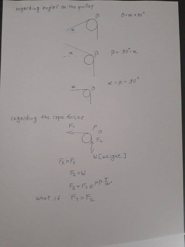

Having been working on problems that included weight, ropes, pulley and friction I wanted to make a sort of reminder. But I need to know if and what changes if F2 > F1
Fx=0
Fy=0

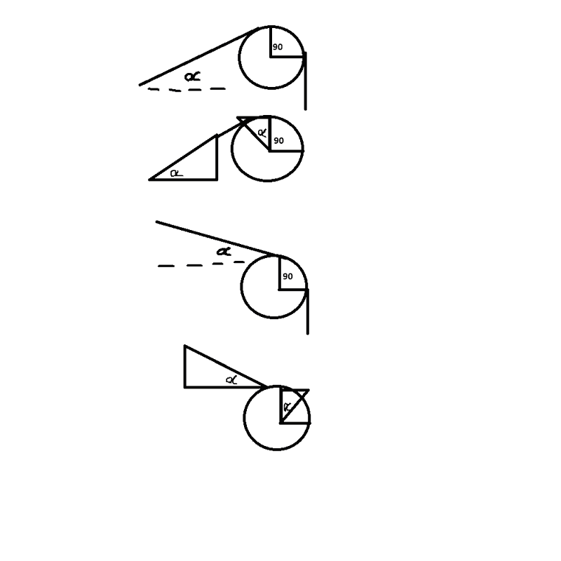

Revisit the angles for the two first cases.
From first diagram, β<90°.
From second diagram, β>90°.
really? Because I thought it goes like this
