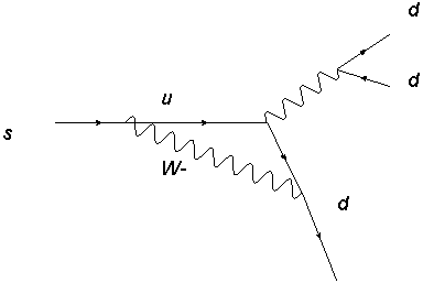

Hello, I am trying to draw a Feynman Diagram at quark level for the decay sigma+ -> neutron + pi+.
uus -> udd + udbar
Well, the attachment is what I came up with. I have no idea if it's right to be honest, I can't see anything wrong with it, but I have no idea how to be methodical about these kinds of drawings, and haven't found any particle physics texts to be much help.
Thanks for your help!

Well I can't see your diagram yet, but I think the diagram requires both a W- boson and a Z boson in it.
At least a W- and then a Z or a gamma.
So I think your diagram looks OK, but maybe someone else would like to confirm it.

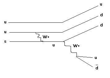

My alternative was:

Ah, yes that looks good, thanks for your help guys, much appreciated.
