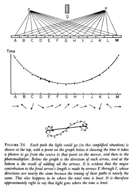

Why does Richard Feyman's explanation for reflection of light say that only some minor differences can be ignored and he sums all the paths between the two points?
Figure 22 - Why does Feynman say that the different lengths A to M are so minor that he is going to ignore them but the time difference differ by the same amount and they are not ignored. Was it just the same for the drawing representation of the arrows?
Figure 24c - Why are different paths A to M vectors added to each other when each path are done independently/in parallel and not sequentially/in series?
What exactly does the sum of all the A to M vectors represent? What does "This also happens when the total time is the least." mean? Vector G is not parallel to the resultant vector sum of A to M so it does _not_ contribute the most to the magnitude in its direction.
Consider, for example, the arrows corresponding to reflections from C and G in Figure 24. Feynman is saying that the lengths of these two arrows can be taken to be approximately the same. He does not say you can ignore the difference in path lengths S-C-P and S-G-P. The difference in path lengths is significant and leads to a significant difference in time for the photon to travel S-C-P compared to S-G-P. This difference in time results in the two arrows having very different directions.

In Figure 24, the “something happening” is the arrival of a photon at P after leaving the source S and reflecting off the mirror.
I haven’t found this exact quote. In the description of Figure 24, I see a similar sentence, “This also happens to be where the total time is least.” This is a statement that positions E through I on the mirror correspond to travel times of the photon that are all approximately equal to the least travel time (G).
The important point is that the length of the total vector (A to M) is largely due to the string of vectors from E through I, roughly. This is because these vectors all have approximately the same direction.

Thanks for your explanations.
Yes, you found the quote that I meant. I had some typos, "when" should have been "to be where"
I guess I didn't expect Feynman's explanations to be so handwavy, even though the introduction by Anthony Zee talks about how it teaches people to "pour all the pebbles out onto a big pile and count them"
I have taken a couple graduate level Physics and Math courses but that was 30 years ago and I'm a EE (although other sparkys would say that Fields and Optics make me a Physics person). The Mathematical Methods in Physics II was a lot of work (that I blame on getting bad advice that taking the part I course wasn't needed)
So, I didn't expect the description to be at that high of a level but that it would have more logic meanings than it has so far.
