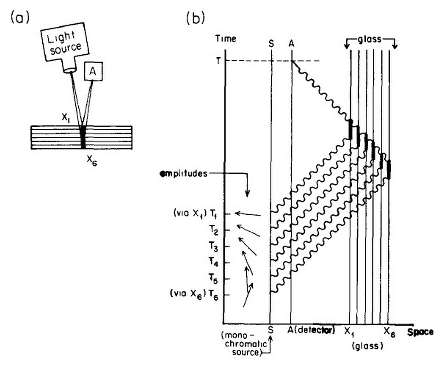

Yes, there is diagram in the book that illustrates this idea:
