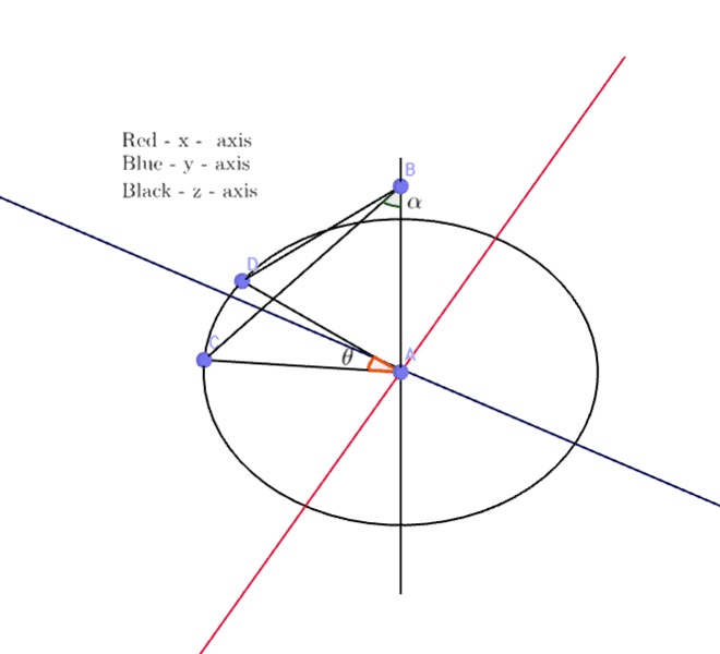

A charge ##Q## is distributed unifromly around a thin ring of radius ##b## which lies in ##xy## plane with its centre at the origin. Locate the point on the positive ##z## axis where the electric field is strongest ?
Geometry diagram in 3D with red x-axis, blue y-axis and black z-axis; a black circle lies in the blue-red plane centred at origin A, with points B on the vertical z-axis, D and C on the circle, and angles alpha and theta marked.
##\displaystyle d\vec E = {dQ \over b^2 + r^2 }\cos \alpha##. ##r## is the distance between the point, ##\alpha## is the angle between ##z## axis and the displacement vector , and the ring along ##z## axis.
##\displaystyle d\vec E = {\lambda dl \over b^2 + r^2 } \cos \alpha = d\vec E = {\lambda bd\theta \over b^2 + r^2 } \cos \alpha##.
Using ##\displaystyle \cos \alpha = {r \over \sqrt{b^2 + r^2}}##.
##\displaystyle E = {br\lambda \over (b^2 + r^2)^{3/2} } \int^{2\pi}_{0} d\theta = {2\pi br\lambda \over (b^2 + r^2)^{3/2} }##
Since ##\displaystyle \lambda = {Q\over 2\pi b}##,
I get,
##\displaystyle E = {Qr \over (b^2 + r^2)^{3/2}}##
Which has a maximum ##\displaystyle r = {2\over 3\sqrt{3}b^2}##.
Am I correct ?
The derivation of the electric field is correct. Your final answer is not. If b is the radius, your value for r has the wrong dimensions. It must proportional to b not to b-2.
Oh that was WA's mistake. I got lazy and let it calculate maxima. Is ## r = \pm b/ \sqrt{2}## correct ?
kuruman said:
Where is b on the right side of the equation?
sorry.
I edited my post. Is the answer ##\pm b/\sqrt{2}## ?
I would pick the positive value because the problem specifies "on the positive z axis". Otherwise it's fine.
