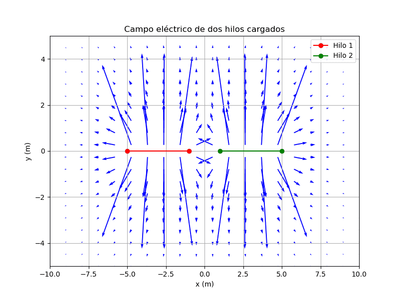

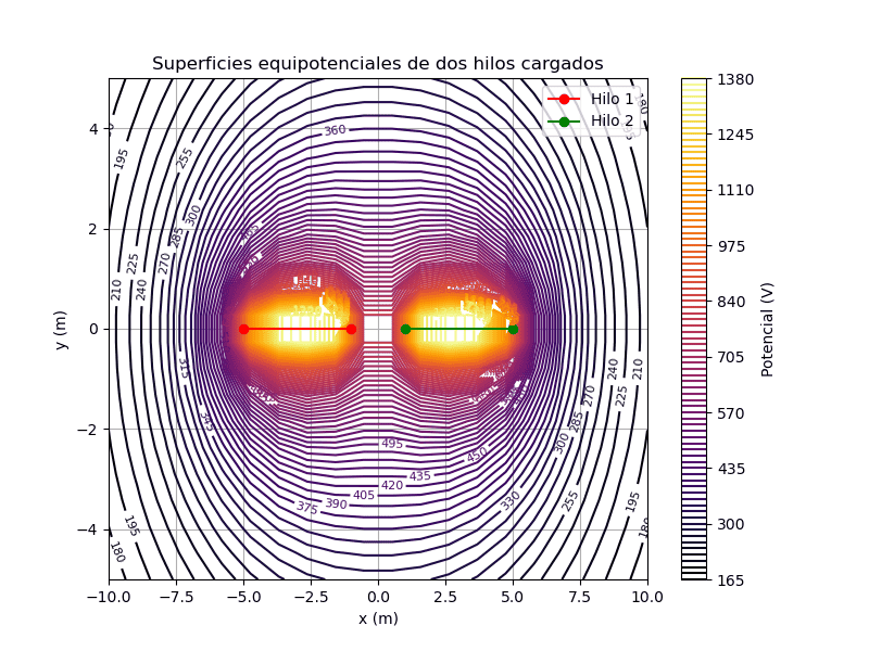

Yes diverge but, is it because the point y=0 is in the same line that wires? ie, the electric field close to (0,0) is very extreme (ideally), I add the graph that illustrate both

Let's take a moment to acknowledge the effort that @darioslc has put in. Not only showing his analytical calculations but numerical/computational results. This example should be followed by every first time poster.

I think it's because you made a mistake in deriving the equation for ##V(x,y).## The total charge on each wire segment is ##Q=3\lambda L##. If you place two point charges ##Q## at ##x = \pm L##, the potential at the origin will be finite and equal to ##V_0=2\times\dfrac{k(3\lambda L)}{L}=6k\lambda##. Stretching the point charges back into linear charge distributions will result in a potential that is less than this value because there will be more charge farther out from the origin. Thus, ##V_0=6k\lambda L## is an upper limit and there is no divergence.
darioslc wrote $$V(0,y)=\frac1{4\pi\varepsilon_0}\lambda\ln\left(\frac{(-R+\sqrt{R^{2}+y^{2}})(5R+\sqrt{25R^{2}+y^{2}})}{(-5R+\sqrt{25R^{2}+y^{2}})(R+\sqrt{R^{2}+y^{2}})}\right)$$
Note that this expression does not diverge as ##y \rightarrow 0## as you can show by taking the limit.
Nevertheless, the above expression for ##V(0, y)## is not correct.
@darioslc: can you show more steps in getting this result? In particular, what did you use for the limits of integration? Also, what does the symbol ##R## represent?
