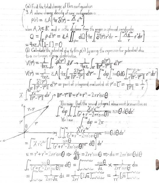

Part (a) was simple, after applying
$$Q=\int_{\mathbb{R}^3}^{}\rho \, d^3\mathbf{r}$$
I found that the total charge of the configuration was zero.
Part (b) is where the difficulties arise for me. I applied
$$V(\mathbf{r})=\frac{1}{4\pi \epsilon _0}\int_{\Gamma }^{}\frac{\rho (\mathbf{r'})}{\left \| \mathbf{r-r'} \right \|}d^3\mathbf{r'}$$
to the given charge distribution. Here's my work.
$$V(\mathbf{r})=\frac{1}{4\pi \epsilon_0}\epsilon _0A\left [ 4\pi \int_{\mathbb{R}^3}^{}\frac{\delta ^3(\mathbf{r})}{\left \| \mathbf{r-r'} \right \|}d^3\mathbf{r}-\int_{0}^{2\pi }d\phi \int_{0}^{\pi }\sin\theta d\theta \int_{0}^{\infty }\frac{\lambda ^2e^{-\lambda r'}}{r'\left \| \mathbf{r-r'} \right \|}r'^2dr' \right ]$$
$$\int_{\mathbb{R}^3}^{}\frac{\delta ^3(\mathbf{r})}{\left \| \mathbf{r-r'} \right \|}d^3\mathbf{r}=\frac{1}{\left \| \mathbf{r} \right \|}=\frac{1}{r}$$
In order to tackle the second integral I tried to use the law of cosines and stipulate that ##\mathbf{r}## is directed along the z-axis. I included the pictures of my work.
$$\int_{0}^{2\pi }d\phi \int_{0}^{\pi }\sin\theta d\theta \int_{0}^{\infty }\frac{\lambda ^2e^{-\lambda r'}}{r'\left \| \mathbf{r-r'} \right \|}r'^2dr'\rightarrow \int_{0}^{2\pi }d\phi\int_{0}^{\infty }\int_{0}^{\pi }\frac{\lambda ^2r'e^{-\lambda r'}}{(r^2+r'^2-2rr'\cos\theta )^{1/2}}\sin\theta d\theta dr'$$
Given that ##\int_{0}^{2\pi }d\phi =2\pi ##
The problem was evaluation of the integral
$$\int_{0}^{\infty }\int_{0}^{\pi }\frac{\lambda ^2r'e^{-\lambda r'}}{(r^2+r'^2-2rr'\cos\theta )^{1/2}}\sin\theta d\theta dr'$$$$\int_{0}^{\infty }\int_{0}^{\pi }\frac{\lambda ^2r'e^{-\lambda r'}}{(r^2+r'^2-2rr'\cos\theta )^{1/2}}\sin\theta d\theta dr'=\int_{0}^{\infty }\lambda ^2r'e^{-\lambda r}\left [ \int_{0}^{\pi }\frac{\sin\theta }{(r^2+r'^2-2rr'\cos\theta )^{1/2}}d\theta \right ]dr'$$
Using the substitution ##u=r^2+r'^2-2rr'\cos\theta##, I was able to integrate with respect to ##\theta## and arrive at
$$\int_{0}^{\infty }\lambda ^2r'e^{-\lambda r'}\times \frac{1}{rr'}\left \{ \sqrt{r'^2+r^2+2rr'}-\sqrt{r'^2+r^2-2rr'} \right \}dr'$$
$$\frac{\lambda ^2}{r}\left [ \int_{0}^{\infty }e^{-\lambda r'}\sqrt{r'^2+r^2+2rr'}dr'-\int_{0}^{\infty }e^{-\lambda r'}\sqrt{r'^2+r^2-2rr'}dr' \right ]$$
Note that I know for sure that the desired potential is
$$V(\mathbf{r})=A\frac{e^{-\lambda r}}{r}$$
However, the last integrals I arrived at, as far as I know, don't yield the answer I'm looking for. The exponential factor ends up canceling out entirely.
Handwritten physics working on lined paper: total charge Q of a volume charge density rho(r) = epsilon_0 A [4 lambda delta(r) - lambda/r e^(-lambda r)], integrated over all space, followed by a potential calculation using a spherical coordinate diagram with vectors r, r' and r-r'.
Handwritten derivation: a note that care must be taken with boundaries since sqrt(r^2+r'^2-2rr') = r'-r is not valid for all r, r', then integrals of λ^2 r' e^(-λr') times (1/(rr'))·{sqrt(r'^2+r^2+2rr') - sqrt(r'^2+r^2-2rr')} dr', split into two integrals with λ^2/r prefactors.
Handwritten notes on lined paper: electrostatic potential integrals V(r) = 1/(4πε₀) ∫ ρ(r')/|r−r'| dV', a delta-function integral, and a 3D coordinate sketch with vectors r, r' and r−r' from the origin.
You need to be careful with the second integral $$I_2=\int_{0}^{\infty }e^{-\lambda r'}\sqrt{r'^2+r^2-2rr'}dr'$$ Remember that you integrate from zero to infinity, in which case ##r'## can be smaller or greater than ##r##. Then depending on where ##r'## is,
$$+\sqrt{r'^2+r^2-2rr'}=+\sqrt{(r-r')^2}=
\begin{cases}
-(r-r') & \text{if } r < r' \\
+(r-r') & \text{if } r \geq r'
\end{cases}$$ which means that you need to split the integral into two, one with limits from zero to ##r## and one with limits from ##r## to infinity. The first integral does not have this wrinkle because ##+\sqrt{r'^2+r^2+2rr'}=+(r+r').##

I'm wondering how I should answer part (c) of this question to get something equivalent to the original charge density divided by the vacuum permittivity for the divergence of the electric field.
After taking your advice, I got that
$$\mathbf{E}=-\nabla V=-\hat{\mathbf{r}}\frac{\partial V}{\partial r}(r)=A\frac{e^{-\lambda r}}{r^2}(\lambda r+1)\hat{\mathbf{r}}$$
$$\nabla\cdot \mathbf{E}=\frac{1}{r^2}\frac{\partial }{\partial r}(r^2E_r)=\frac{A}{r^2}\frac{\partial }{\partial r}\left ( \frac{r^2}{r^2}e^{-\lambda r} (\lambda r+1)\right )=-A\frac{\lambda ^2e^{-\lambda r}}{r}$$
But the original charge density is
$$\rho (r)=\epsilon _0A\left [ 4\pi \delta ^3(\mathbf{r})- \frac{\lambda ^2}{r}e^{-\lambda r}\right ]$$
You are missing the delta function which is zero everywhere except at the origin. Your expression for the divergence is good except at the origin. Is ##\dfrac{r^2}{r^2}=1## at ##r=0##? I think not.
Right, right, thanks a ton.
