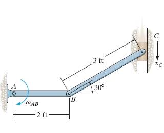

The block at C is moving downward at vc = 4.8 ft/s. Determine the angular velocity of bar AB at the instant shown.
x = cross product
r = distance to point from frame of reference
Boldface will indicate vectors
v = ω x r
vB = vA + ω x rB/A = vA + vB/A
vB = ωAB x rB/A = -2*ω[itex]\vec{j}[/itex]
vC = vB + ω x rC/B
-4.8[itex]\vec{j}[/itex] = -2*ω[itex]\vec{j}[/itex]+(-ω[itex]\vec{k}[/itex] x (3cos(30)[itex]\vec{i}[/itex]+3sin(30)[itex]\vec{j}[/itex]))
Taking the cross product and setting the y-components equal to each other, I get ωAB=1.04 rad/s. The correct answer is ωAB = 2.40 rad/s. From working backwards, I believe the correct answer can be obtained by setting vB equal to vC:
If this is correct, my question is why can they be set equal to each other while disregarding ωBC and rC/B?
In your attempt at a solution you assumed that ωAB = ωBC which is not the case.
The length of rBC is constant and at the instant in time there is no component of v in the i direction. Therefore, ωBC = 0 and vB = vC.
