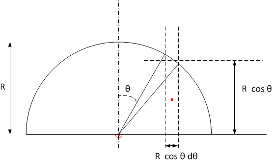

With ##R\cos\theta## the height of such a slice, what would you have for the width ? I would guess ##\ R\cos\theta\ d\theta\ ## And the center of mass of such a slice would be at ##{R\over 2} \cos\theta##. It might work. Make a drawing to check what you are doing.

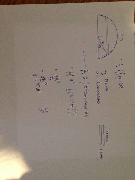

Hi- I did draw it out, but unfortunately cannot scan it in. The best way I can describe what I am doing is by saying that I'm calculating it in the same way I would the moment of inertia by dividing the semicircle into rectangles of length ## 2 R sin \theta## (or ## sin \theta## depending on how you define your angles) and width ##Rd \theta## It does not appear to give the correct answer...

Hi- sorry if I was not being very clear. This is what I had meant :) but I can't see my mistake

The rectangular strip has its long side of length 2‧R‧cosθ
but its dimension perpendicular to this is ...
Oh okay so it should be ##dy= Rcos \theta d \theta ## in place of ##R d \theta## ? :)
And it comes out with that correction! Thank you so much :)
