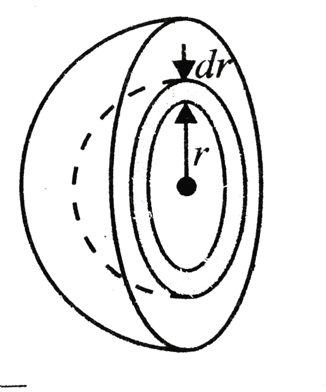

find the center of mass of a solid hemisphere of radius R.
##Y_{cm} = \frac {1}{M} \int y dm##
for this derivation, I decided to think of the solid hemisphere to be made up of smaller hemispherical shells each of mass ##dm## at their respective center of mass at a distance r/2 from the center of the base of the solid hemisphere.
also, I have taken the center of the base of the solid hemisphere to be the origin. Due to symmetry, I know that the center of mass of the solid hemisphere is along the Y-axis.
I found the mass ##dm## of all the small hemispherical shells
$$dm = \frac {M}{(4/6)\pi R^3} (\frac{4\pi}{3}r^2 dr)$$
substituting ##dm## into $$Y_{cm} = \frac {1}{M} \int \frac {r}{2} dm $$
gives me ##Y_{cm} = R/4## which is wrong.
also, I know this can be done in a slightly easier way if you consider the hemisphere to be made up of solid discs but I thought I'd give this method a go! can someone help point out what exactly I am doing wrong here:)

I have considered the large solid hemisphere to be made up of smaller hemispherical shells whose center of mass we know is at ##r/2## and is of mass ##dm##
Hamiltonian299792458 said:
View attachment 269250I have considered the large solid hemisphere to be made up of smaller hemispherical shells whose center of mass we know is at ##r/2## and is of mass ##dm##
Why is the CoM of the shell at ##r/2##?
hmm...because you can derive that by breaking the hemispherical shell into rings of mass ##dm## whose CoM lies at their centers and then you end up with $$Y_{cm} = 3R/2\int_0^{\pi/2}cos\theta sin^2\theta d\theta = R/2$$
the origin is at the center of the base of the hemispherical shell and R is the radius of the hemispherical shell.

$$Y_{cm} = \frac {1}{M} \int \frac {r}{2} dm$$ so this is wrong?
Consider a thin hemisphere of thickness ##dr##, and mass ##dm = 4\pi r^2 \rho dr##. Since the hemisphere is of infinitesimal thickness, its centroid is at ##\frac{r}{2}## in the ##y## direction. The sum of the first moments of mass of all of these tiny hollow hemispheres, which combine to make a solid hemisphere, in the ##y## direction, ##S_y##, will be$$S_y = \int_0^R y dm = 2\pi r^3 \rho dr$$Can you take it from here?
I think this is not right. It should be ##2\pi r^2 dr## for a shell of radius ##r## and thickness ##dr##.
PS I thought it was simpler to integrate disks of radius ##r## and height ##dz##:
$$dm = \rho \pi r^2 dz = \rho \pi (R^2 - z^2)dz$$
what exactly should be ##2\pi r^2 dr##? ##dm##?
also, I am considering the mass per unit volume.
In place of the volume formula you used.
how exactly did you get that?
I got the volume of ##dm## as $$=\frac {4\pi}{6}(r + dr)^3 - \frac {4}{6}\pi r^3$$
$$\approx \frac {4\pi}{3}r^2dr$$

That's definitely not right. I took the surface area times ##dr##. It should come to the same thing.
What do you get when you expand ##(r + dr)^3##?
