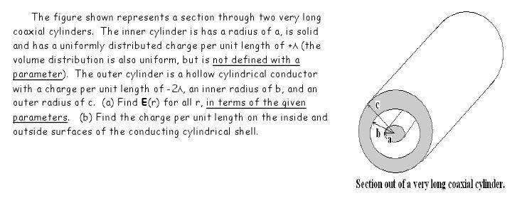

two very long coaxial cylinders. Inner has radius a and is solid with charge per unit length of λ. Volume is also uniform but not defined by a parameter. Outer is hollow with inner radius b and outer radius c. Outer cylinder is a conductor with charge per unit length of -2λ. Find E(r) for all r in terms of given parameters. you can also view attached picture.
∫E.dA=qenclosed/ε0
I'm hung up right away on what to do with the inner radius from 0->a I've got the left side of the equation I think, but I don't know how to get qenclosed in terms of r, if it needs to be. I expect to integrate on that part. Anywho here's where I'm at.
E2∏rh=(1/ε0)∫dq
I've got λ=dq/dh where h represents the length of the cable being considered. All the examples seem to use charge density rather than charge per unit length, using this gives me:
E2∏rh=(1/ε0)∫λdh which is not in terms of r. I suppose I could still integrate it and cancel h on both sides, let me know if that's wrong.
E2∏rh=(λh/ε0)→E2∏r=(λ/ε0)
E(r)=λ/(2∏r*ε0)
Is this wrong for any reason? It doesn't feel right to not use the radius on the right side.

Let's consider the cable's length finite, L. The total charge of the inner cylinder would be Q = λL. Applying Gauss' theorem ∫E*dA = λL/ε°, since E is uniform and perpendicular to dA: E∫dA = λL/ε° <=> E(2πrL) = λL/ε° <=> E = λ/2πε°r.
The units on both sides are also ok, so your formula is right.
