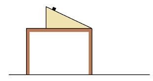

A small block is on the point of slipping down a rough ramp inclined at 35 degrees to the horizontal.
a) What is the coefficient of static friction between the block and the ramp?
Answer μ_s = 0.70
b) The ramp is attached to the edge of a 0.8 m high table. After the block is given a small nudge it slides down the ramp and lands on the floor a horizontal distance of 0.4 m away from the edge of the table. What is the coefficient of kinetic friction between the block and the ramp?
Answer μ_k = 0.62

Could the setup for part (b) be as shown:
Was any information given about the initial height of the block on the ramp?

Perhaps but no there is no info regarding the height of the block on the ramp if it is that set up.
In part (b) it says that the block is given a small nudge to get started. This means that the block is initially on the verge of slipping as in part (a). So, I'm "inclined" to think that the ramp is still sloping at 35 degrees in part (b).
Anyway, I don't think enough information is given to work the problem if the ramp is on top of the table as shown in the figure I posted.

I agree, there isn't enough info for that figure. Also the reason i assumed the angle changes is due to the fact that if theta is 35 degrees length x and height y do not correspond to the correct values.

Too bad they didn't provide a figure. If the setup is as I indicated, then working backward from the given answer, I get that the block must have been placed at a vertical height of 1.0 m from the base of the ramp (i.e., 1.0 m above the table top).

As before using work energy theorem, however what of the 0.8 m height of the table itself?
What can you learn about the motion of the block at the bottom of the ramp from the fact that the table is 0.8 m high and the block lands 0.4 m horizontally from the edge of the table?
