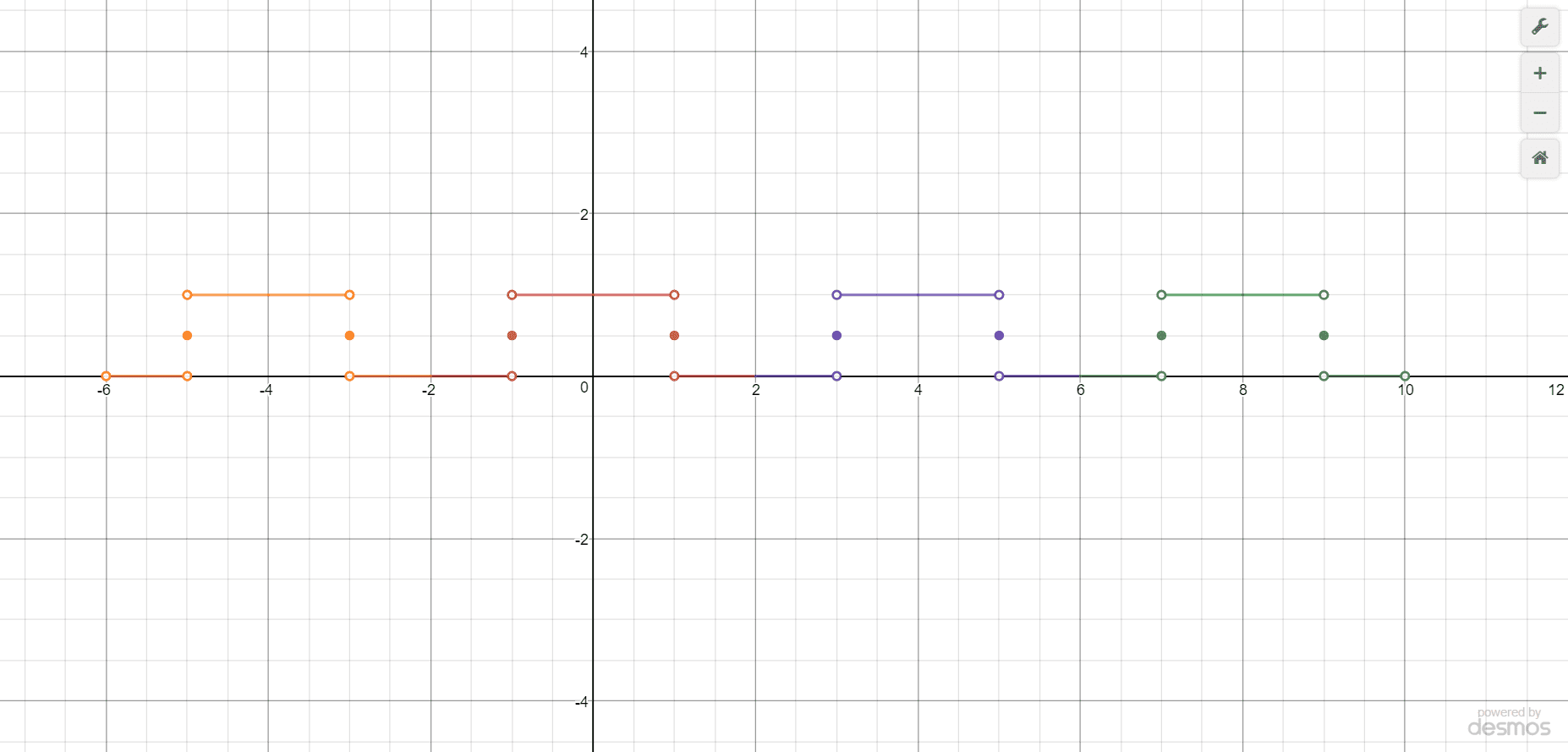

Hello!
I want to find the Fourier series for the given function $f$:
$f(x)=\left\{\begin{matrix}
1, & 0<x<1,\\
0, & 1<x<2
\end{matrix}\right.$
-> cosine series, period 4
I also want to find the graph of the function to which the series converges , for three periods and then make some comparisons with 2 other examples.In order to find the cosine Fourier series, do we have to find the even extension of $f$? If so, will this be equal to $0$ for $-1<x<0$ and to $1$ for $-2<x<-1$ ?
But then the extension wouldn't be $4$-periodic? Would it? (Worried)

Ok... The coefficients of the cosine Fourier series are given by the following formulas:
$$a_n=\frac{2}{L} \int_0^L f(x) \cos{\frac{n \pi x}{L}} dx, n=0,1,2, \dots \\ b_n=0, n=1,2, \dots$$
So in our case $a_0= \int_0^2 g(x) dx=1$ and $a_n=\int_0^2 g(x) \cos{\frac{n \pi x}{2}} dx=\int_0^1 \cos{\frac{n \pi x}{2}} dx=\frac{2}{n \pi} \sin{\frac{n \pi }{2}}$.
So the Fourier series is of the following form, right?
$$f(x)=\frac{1}{2}+ \frac{2}{\pi} \sum_{n=1}^{\infty} \frac{\sin{\frac{n \pi }{2}}}{n} $$

Ah it is as follows:$$g(x)=\frac{1}{2}+\frac{2}{ \pi}\sum_{n=1}^{\infty} \frac{\sin{\frac{n \pi}{2}}}{n} \cos{\frac{n \pi x}{2}}$$
If $n$ is even, then $\sin{\frac{n \pi}{2}}=0$.
If $n$ is odd then $n=2k-1$ for some $k \in \mathbb{Z}$.
Then $\sin{\frac{n \pi}{2}}=\sin{\frac{(2k-1)\pi}{2}}=\sin{\left(k \pi-\frac{\pi}{2}\right)}=\sin{k \pi} \cos(-\frac{\pi}{2})+\cos{k \pi} \sin{\left(-\frac{\pi}{2}\right)}=-\cos{k \pi}=(-1)^{k-1}$.
So, $g(x)=\frac{1}{2}+\frac{2}{ \pi}\sum_{k=1}^{\infty} (-1)^{k-1} \frac{1}{2k-1} \cos{\frac{(2k-1) \pi x}{2}}$The graph of the function to which the Fourier series converges is the following, right?View attachment 6579
Yep. All correct. (Nod)

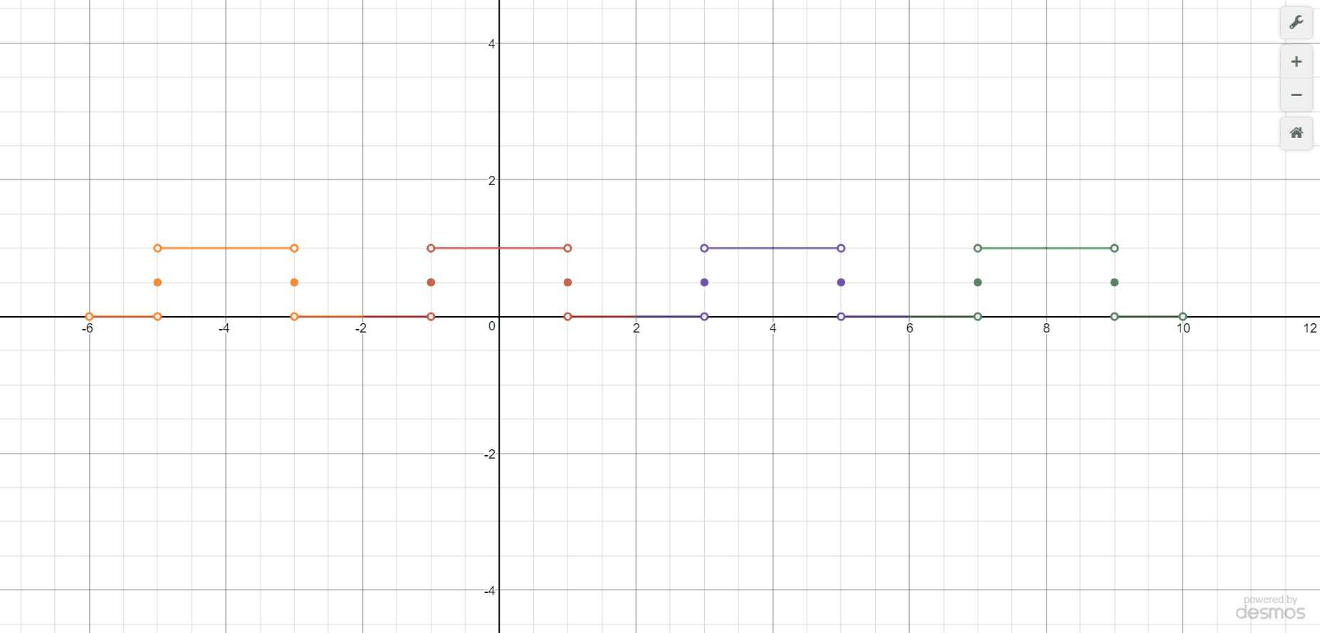

I have found that the Fourier series is the following:
$f(x)=\frac{1}{2}+ \frac{2}{ \pi} \sum_{n=1}^{\infty} \frac{1}{2n-1} (-1)^{n-1} \cos{(2n-1)x}$.What observations could we make? (Thinking)
Can we graph them? (Wondering)
The formulas are very similar, (1) with a sine instead of a cosine, and no alternating $-1$.
And (2) with only a different factor inside the $\cos$.
The graph for (1) looks pretty different though, and for (2) the effect is a scaling along the x-axis.
