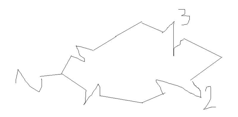

the image of circuit is in attachment
the question is to find the current through the battery
I think that there is a y connection
so above two and centered one form y from formula the whole resistance is 1
than I imagine bottomed ones and this and above ones as new y type connection and
I get 1/R = 1/(1/1 + 1/2 + 1/3) and r is equal to 11
all in all the current should be I=U/R = 3/11
but in book the answer is 21/19
please help

you can use delta to y conversion
Please show the formula used and the details of how you applied it for your Y to Δ transformation. What do you mean by the "whole resistance is 1"?

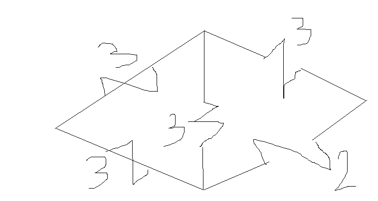

this is the your current equivalent circuit you could change it to the form of
using
sorry for my poor drawing skills
1/R = 1/(1/r1+1/r2+ 1/r3)
i am sorry i will draw again

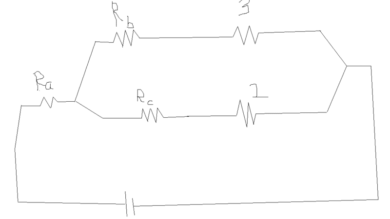

the 3 and 2 are the same old resistors but Ra , Rb , Rc are resistances to be determined using the delta to y conversion hope this clears up
what i am saying is that this circuit is equivalent to the old circuit if proper values of resistance for a b and c are used
i don't understand what formula that is
This is the formula for finding the equivalent resistance of 3 resistors in parallel. Not the delta-wye formula.
