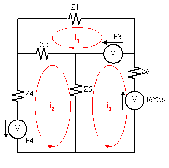

Find currents in every loop of the circuit, find voltage on every element,build vector schelude for currents in the circuit.
R1=35 Ohm
R2=40 Ohm
R5=30 Ohm
R6=20 Ohm
L4=25millihenry
C4=40microfarad
E3=15*sin(300t-60)
E4=29
j6=1.25*sin(300t+75)
Z4=(RL4+RC4+r4)
I've found resuts.But when I wanted to check it with power balance the values were completely different.(Sum(e*I) !=Sum(I^2*r) at all.completely different values)

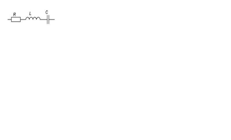

  • Circuit schematic of a series RLC branch with a resistor labelled R, an inductor labelled L and a capacitor labelled C in a single line.
What is r4?
What are RL4 and RC4?
Is Z4 supposed to be a compound component consisting of an R and L and a C in series?
Are the other Z's just assigned the corresponding components, such as Z1 = R1, Z5 = R5, and so on?
Yes.It's just a symbol.It's easier to use this symbol in equtations.[/QUOTE]

The problem is, I don't know what directions you initially assumed for your current directions. So it's difficult for me to say. Here's a version of your circuit redrawn with the current supply replaced by its Thevenin equivalent and some assumed loop currents. How does it compare with what you've assumed?
  • Circuit schematic with three red loop currents labelled i1, i2 and i3, resistors Z1, Z2, Z4, Z5 and Z6, voltage sources E3 and E4, and a source J6*Z6 in series with Z6.
Then the current flowing downward through Z5 will be I2 - I3. Leave the signs of the currents I2 and I3 alone, but look at the result of I2 - I3. If it's positive then then current "really is" flowing downwards. If it's negative, then the current actually flows upwards.

We seem to have chosen a different numbering for the loops (your loop 2 is on the right). But that's a small thing.
I see in your calculation for loop 1 that you've got I3 flowing through R1. Is that true?
I've attached my version of the calculations (.mcd file in zip format) so that you can compare.
EDIT: I've replaced the attachment with a more complete, and hopefully bug-free version.
