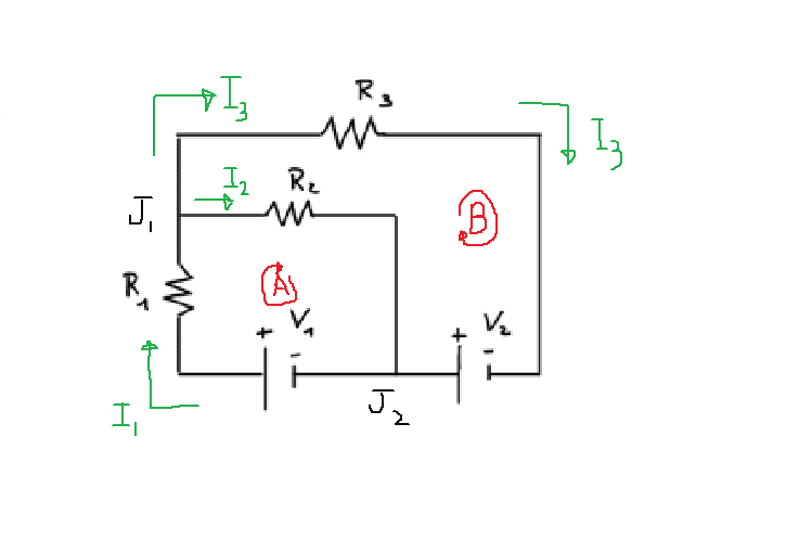

Hi,
i'm stuck on this problem and have been trying to identify where I might have made an error but have come up empty. I have assigned my loops and junctions and have three equation for three unknowns, but can't seem to solve them...
Consider the circuit in the following diagram (attached):
where the two ideal dc batteries deliver a terminal voltage of V1 = 2V and V2 = 10V respectively. The magnitude of the resistances is R1 = 2Ω; R2Ω = 2; and R3 = 3Ω. Calculate the magnitude and direction of the current across the resistor R2.
Kirchhoff's junction and loop rule.
I1 = I2 + I3 (JR)
v1 - I1R1 - I2R2 = 0 (loop A)
-I3R3 + V2 + I2R2 = 0 (loop B)
I can't see how to solve for any of these, which is making me think I've worked out the expressions wrong, but I can't find the mistake.
Thanks for any help you can give,
BOAS

Your equations look fine. Must be something to do with your mechanics of solving the equations. Guess you'll have to provide some details there.
BOAS said:
I1 = I2 + I3 (JR)
Your work looks fine.
You have three equations and three unknown so there should be no problem .From first equation find the value of i3 and substitute into 2nd and 3rd equations .You will be left with two equations and two unknowns.

I3 = I1-I2
Subbing into the 3rd equation gives;
V2 + I2R2 - (I1-I2)R3 = 0
I don't see what you meant, when you said to sub I3 into the second equation.

Now you have two equations and two unknowns i1 and i2.The values of V1,V2,R1,R2.R3 are given in the problem statement. Just solve the two equations.

I've been making this far hard than it needs to be - I definitely need to go back and practice simultaneous equations again. I had completely forgotten to multiply the equations by a number to make elimination possible.
Multiplying V1 - I1R1 - I2R2 = 0 by 3/2 makes the elimination work.
I get an answer for I2 = -7/8 A which means the current goes the other way round.
Thank you for your help.
