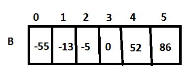

I want to describe an algorithm that given an unsorted array $B$ that stores $m$ integers, and any integer number $y$, determines if there are two elements of the array of which the quotient is equal to $y$. The time complexity of the algorithm should be $O(m \log m)$.

How could we check if there are two elements of the array of which the quotient is equal to $y$? (Thinking)

For example, if we are given that $y=11$ and we have this array:
then since $\frac{B[0]}{B[2]}=\frac{-55}{-5}=11$ we conclude that there are two elements of the array of which the quotient is equal to $y$.

You can do the following.
1. Sort the array.
2. For each element $x$, find $x/y$ in the sorted array using binary search.
