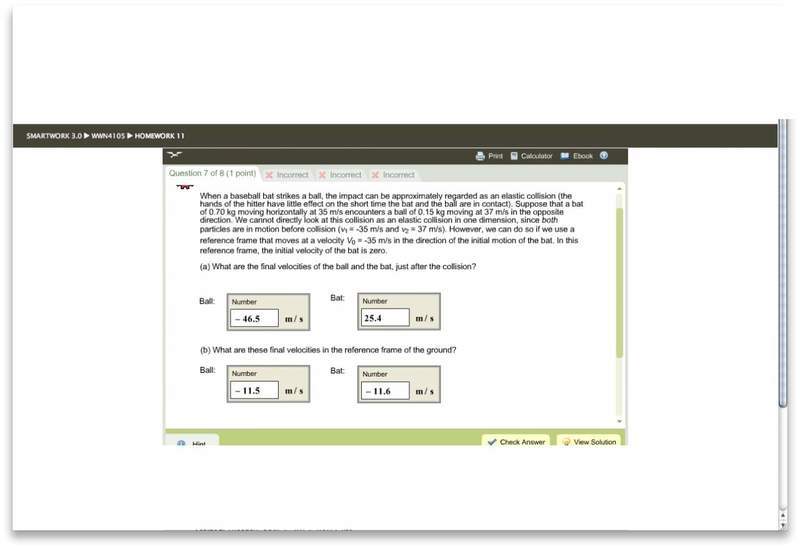

Find final velocities in the reference frame to the ground.
30 replies · 4K views · last reply
Sneakatone
318
for the 1st two I used
v is to the reference frame = 37m/s- -35m/s=72m/s
a)ball=[(m2-m1)/(m1+m2)]v
bat=v2=[(2m1)/(m1+m2)]*v
b) I do not know how to solve for part b.

When you solved a), you obtained the velocity of the ball in the bat's reference frame by subtracting -35 m/s from the velocity of the ball in the ground frame. What do you need to do to obtain the velocity of the ball in the ground frame from its velocity in the bat's frame?
do I need to find the reference frame for v2?
The reference frame for v2 and everything else you computed is the reference frame of the bat just before the strike.
so how would I find find final velocities in the reference frame to the ground?
You have successfully converted from a ground frame to a moving frame. You did that by subtracting the velocity of the moving frame (relative to the ground frame) from the velocities of two objects (initially taken relatively to the ground frame) to obtain their velocities relatively to the moving frame. Now you have some velocities taken relatively to the moving frame, and you want to convert them to the ground frame. Given all of the above, is it not obvious how?
If not, consider this. Say there is a train going at 100 km/h (relatively to the ground). You are in the train and walking along it at 5 km/h. What is your velocity relatively the ground if you walking in the direction of the train's motion? Against?

It is, but do you understand why that is so? If the train's velocity w.r.t. the ground is V, and your velocity w.r.t. the train is v, what is your velocity w.r.t. the ground?
Very well.
Now let's go back to the original problem. The frame initially co-moving with the bat is the train. What is V?
The velocities you got after the collision are relative to this frame, i.e., the "train". Can you find the velocities w.r.t. the ground?
so the bats velocity would be V=-35m/s
making velocity to the ground -81.5m/s
making final velocity of the bat to the reference to the ground -81.5 m/s.
So it was going -35 before the collision, and is going -81.5 - even faster and in the same direction - after the collision. How is that possible? What velocity do you get in the moving frame?
That is the velocity of the ball in the moving frame BEFORE the collision. What velocities in the moving frame did you get AFTER the collision?
Excellent. You have these and you have the velocity of the moving frame w.r.t. the ground. What prevents you from applying the formula you got in #19?
