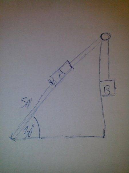

A mass(A) of 12kg is on a slope with an angle of 30 degrees.
The static coefficient of friction of the slope = 0.5 (μs)
The kinetic coefficient of friction 0.3
The length of the slope from the block= 5m
However the The mass(A) is connected to another mass(B) which is hanging over the edge.
Q. What is the maximum mass (B) can be before mass (A) will begin to move.
M(B) ≤ μsM(A)
[/B]
I just subbed into this 0.5 x 12 = 6 Kg
but my teacher marked it wrong on the test.
Is it possible the fact its on a slope will have anything to do with it so do I use the angle in some way?
Yes, so your equation is not correct.
Okay is it that it is incorrect as in doesn't exist or i used the wrong one
Suppose that the mass MB wasn't there. Would you know how determine whether of not the mass A slides down the slope? If so, show us how you would do it. Once you do this problem, you will know what to do with the present problem in which MB is trying to make MA slide up the slope.
