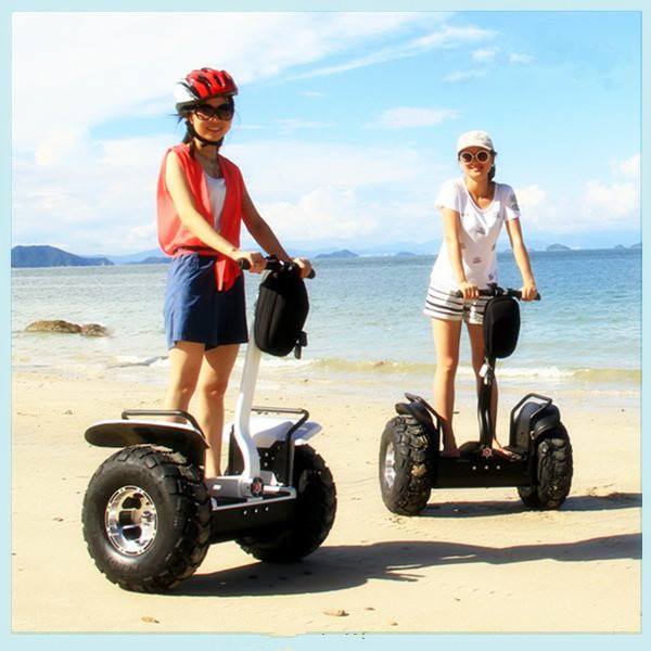

Also, how are you going to stabilize your 2-wheeled robot? Will you use some gyroscopic stabilization scheme like for the Segway?
