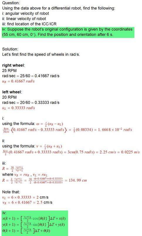

Data:
The speed of right wheel is considered to be 25 RPM.
The speed of left wheel is considered to be 20 RPM.
The distance, L, between wheels is 30 cm.
Also the radius, r, of each wheel is 6 cm.
Question:
Using the data above for a differential robot, find the following:
i: angular velocity of robot
ii: linear velocity of robot
iii: find location of the ICC/ICR
iv: Suppose the robot's original configuration is given by the coordinates
(55 cm, 60 cm, 0°). Find the position and orientation after 6 s.
I need help with part iv.
I tried to use Euler's approximation for part iv.
$$x(k+1)=\left[ \frac{v_{L}+v_{R}}{2}\cos \left\{ \theta (k\right\} \right] \Delta T+x(k)$$
$$y(k+1)=\left[ \frac{v_{L}+v_{R}}{2}\sin \left\{ \theta (k\right\} \right] \Delta T+y(k)$$
$$\theta (k+1)=\left[ \frac{v_{L}+v_{R}}{L}\right] \Delta T+\theta (k)$$
I tried to solve it here. Please jump to the part iv at the bottom. I tried to implement it in Matlab but it looks like something is wrong. I understand that there would be far better ways to write the code but I wanted to know if my method is okay. Could you please help me with it? The way I did it x(k+1) and y(k+1) give total distance moved but aren't x(k+1) and y(k+1) supposed to give coordinates of the point the robot is at after 6 seconds?

  • Typed solution to a differential robot problem, with handwritten-style red equations for wheel speeds, angular and linear velocity, ICC/ICR radius, and the Euler position update equations for part iv.

It seems that there is an error in the calculations of the angular velocity of each wheel, as rpm were converted to rad/s.
According to my calculations:
##\omega_L=2.094~rad/s##
##\omega_R=2.618~rad/s##
Arc described by each wheel should be 12.56 cm/s for left wheel and 15.70 cm/s for right one.
Radius of rotation around a common vertical axis should be 142.73 cm for left wheel and 172.73 cm for right one.
If all the above is true, the angular velocity of the robot about that vertical axis should be 0.089 rad/s.
In 6 seconds, it should sweep a counter-clockwise angle of 0.534 rad or 30.6° measured from the original position and orientation.

Thank you for pointing out this mistake. I have fixed it and got the right answer after making some changes to the code.
