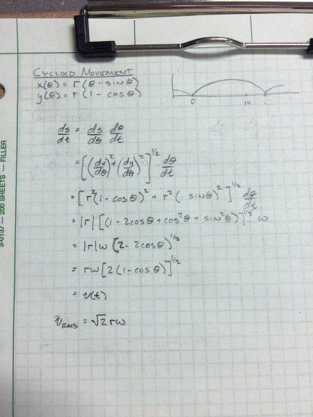

Here's my attempt at an explanation:
The equivalent point mass of the wheel is traveling along a cycloid path. The speed at which it's traveling I calculated is given by the function ##v(t)=r\omega \sqrt{2(1-\cos{\theta})}## for ##\theta \in [0,2\pi]##. I figured a good average value would be the RMS speed. If you take the root mean square, you get ##v_{RMS}=\sqrt{2}r\omega##. Plugging that into the translational kinetic energy equation, ##KE=\frac{mv_{RMS}^2}{2}=\frac{m(2r^2\omega^2)}{2}=mr^2\omega^2##. If we assume no slip in the wheels, then we can say that ##v=r\omega## and also ##mv^2=mr^2\omega^2##.
If we look at the wheel with the rotational/translational method, ##KE=\frac{mv^2}{2}+\frac{I\omega^2}{2}##. Since this is a thin tube, ##KE=\frac{mv^2+mr^2\omega^2}{2}=\frac{2mv^2}{2}=mv^2##.
My derivation for the point mass speed along the cycloid path is as follows:
