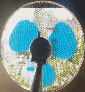

Thank you for all the replies. I didnt get a chance to do a full test yet, but i did a quick one just to see if this is even possible.
I used a mobile phone that can record at 240fps (Samsung S7 edge), pointed it at the fan and the stop watch next to it. I only did a 10 second recording and actualy only counted the frames for 1 second. I counted 6 turns in 1 second, which would indicate 360 rpm. Which would make sense since i am only supplying about 10W into a fan that has 48W motor. I cropped the image so you cant actualy see the stop watch running next to fan. I converted it into animated gif, i hope this forum supports it. What you see in a gif are steps frame by frame, i used vlc for that, i could also use a 0.03% speed in it or just extract all frames from a video and check them, though using vlc is easier.
Now to get a more precise measurement i will obviously have to do a measurement for like 10 seconds instead of 1, but for starters it is ok. And besides, it is not the raw number of frames that i am interested in, but rather comparison between 2 modes A and B and what i want to know is which of them has higher rpm. Unless i am missing something i should be able to do that, maybe even at higher rpm, judging by how many frames i record before fan makes a full turn, i should be able to measure this at 1000rpm or even higher. Again, unless i am missing something big here and the whole process is false.

No, it all looks good to me. The high frame rate of 240 fps obviously helps here.

Looking at your short video, I can see some odd artefacts (spots) on the blades as they go through the 1 o'clock position. I think they could be sampling artefacts Try with a high and a low sample rate and spot any differences. Have fun.

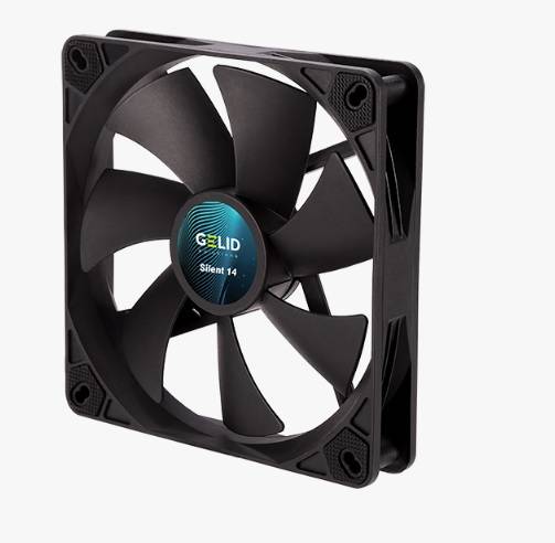

Take a look at a low speed muffin fan, such as this one: https://www.digikey.com/en/products/detail/gelid-solutions-llc/FN-PX14-11/16714422.
These style fans are used for cooling electronics. This particular one is rated 21 dB(A), which is so quiet that few people could hear it in a normal room. It's not the only possibility. It's rated to draw 0.09 amps at 12 volts, or 1.1 watts. The square fan housing allows you to set it on a table without a special mount or stand.
You can find a selection by searching the web site for fans, desired voltage, and RPM. The low RPM fans are the quiet ones, the larger ones move more air. It's also available from Amazon: https://www.amazon.com/dp/B09QT8MMDW/?tag=pfamazon01-20.

Would the airflow be anything like enough for a room? Surely everyone would use them if it was enough for venting rooms. Also, extractor fans need to cope with varying pressure differentials as conditions change.

As for pc fans, that would obviously be fantastic, i have probably about 100 fans with sizes between 4 and 14cm. Sadly there are a lot of nights when i enjoy running the fan at max over night and due to configuration on my apartment, it really makes a huge difference in temperature when running a big table fan, i think its like 40cm. I could stack a few 140mm fans together but due to multiple rotors that would certanly lose any energy efficiency advantage over big AC fan. Since fan is blowing out of the window in my storage room, i can just slightly open windows in all other rooms, including bedroom and i get huge airflow there with zero noise. I am finishing my mini esp8266 device that will measure inside and outside temperature/humidity to automaticaly start and stop the fan when it makes most sense to run it, taking lowering temperature and humidity in apartment as first goal. Apart from temperature/humidity i use this fan to improve odor. This fan obviously is just a temp solution since its a table fan not meant to be mounted on a wall hole and its energy efficiency is probably not very good. I have a few ideas of what i want and how to accomplish, though this setup right now is doing just good enough job to not make me wanna do anything new in a hurry. I really like fans, have a bunch of them around apartment doing various tasks 24/7 :)

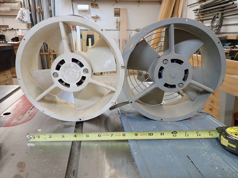

Also, this is a pair of 250 mm high speed fans that I had laying around. They were too noisy for use as room air circulators, so I wired them in series. That slowed them down to a speed where they move air with almost no noise. I have not used them in years, so I think they will be taken to the dump soon.

Those look like something i would put on a shelf as a decoration. Real nice :)

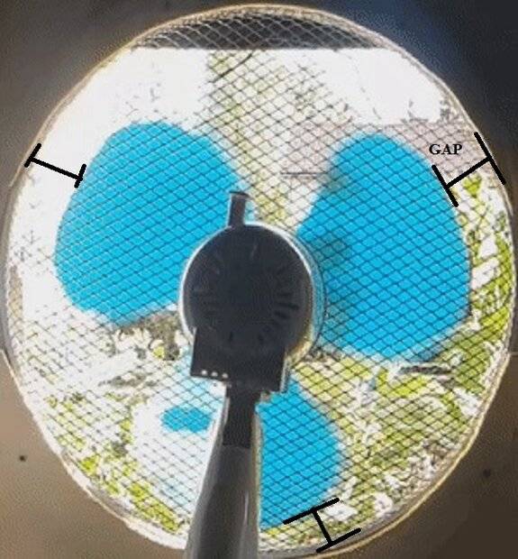

I have another question and i decided to first try ask it here before opening a new thread, hopefuly someone will read it. It's real simple.
From time to time i will read some article about new computer fans, mostly interested in how physics is used to further improve them. One of the things i read was that some news speakers are made from some new/better plastic material that is harder and more expensive. So from what i read, what this is supposed to do is that at high rpm, the blades of the fan will change their shape less than they do with cheap plastic. And because of that, they can put blades closer to the fan case and therefor slightly improve airflow.
Now how much this is noticable and how much its market material i dont know. But it got me thinking about my fan i use on a wall. It's a table fan that is obviously not made for what i use it for but its doing an ok job. But when i installed it i noticed 1 weird thing. If i use a piece of paper or smoke to figure out where air is going, if i put it behind the spinning blades, air and smoke will obviously be drawn out from the apartment. But as you can see on a picture, there is a big gap between blade's edge and the wall case. And there, the air is actualy blowing into the apartment. At first i thought that was just some turbulence or something but now that i think about it, it actualy makes sense. As the blades push air out, this gap is the easiest way to draw air in. That is actualy not what i want - i want as much air as possible to be drawn through the window in the other room.
So i am wondering, is there any way to approximate how much airflow/pressure is lost due to this gap, if i measure the fan blades and this gap ? I am not looking for exact number but it would be good to know whether 5% is lost (which is ok) or 30% is lost (in which case it would make sense to make a wooden frame that will move closer to fan blades)
I think it's more complicated than that. A fan running in a duct can produce more air flow than the fan alone Think about all the various designs of aero engines depending on the speed you want the aircraft to travel and what efficiency you require (and the acceptable noise level), they use different widths of duct and different lengths. Then the shapes of the blades has an effect. So I think 'it all depends'. Aerodynamics is a very hard subject, too.
There is no simple easy way to get a good measurement of the percentage of air back flowing. But you can get a good idea by generating a thin stream of smoke that gets sucked into the fan. Just be aware that the percentage of back flow depends on the back pressure. If the fan is pushing into the wind, or trying to suck air out of a closed room, there will be more back flow. The back flow could range from near zero to 100% depending on the back pressure.
